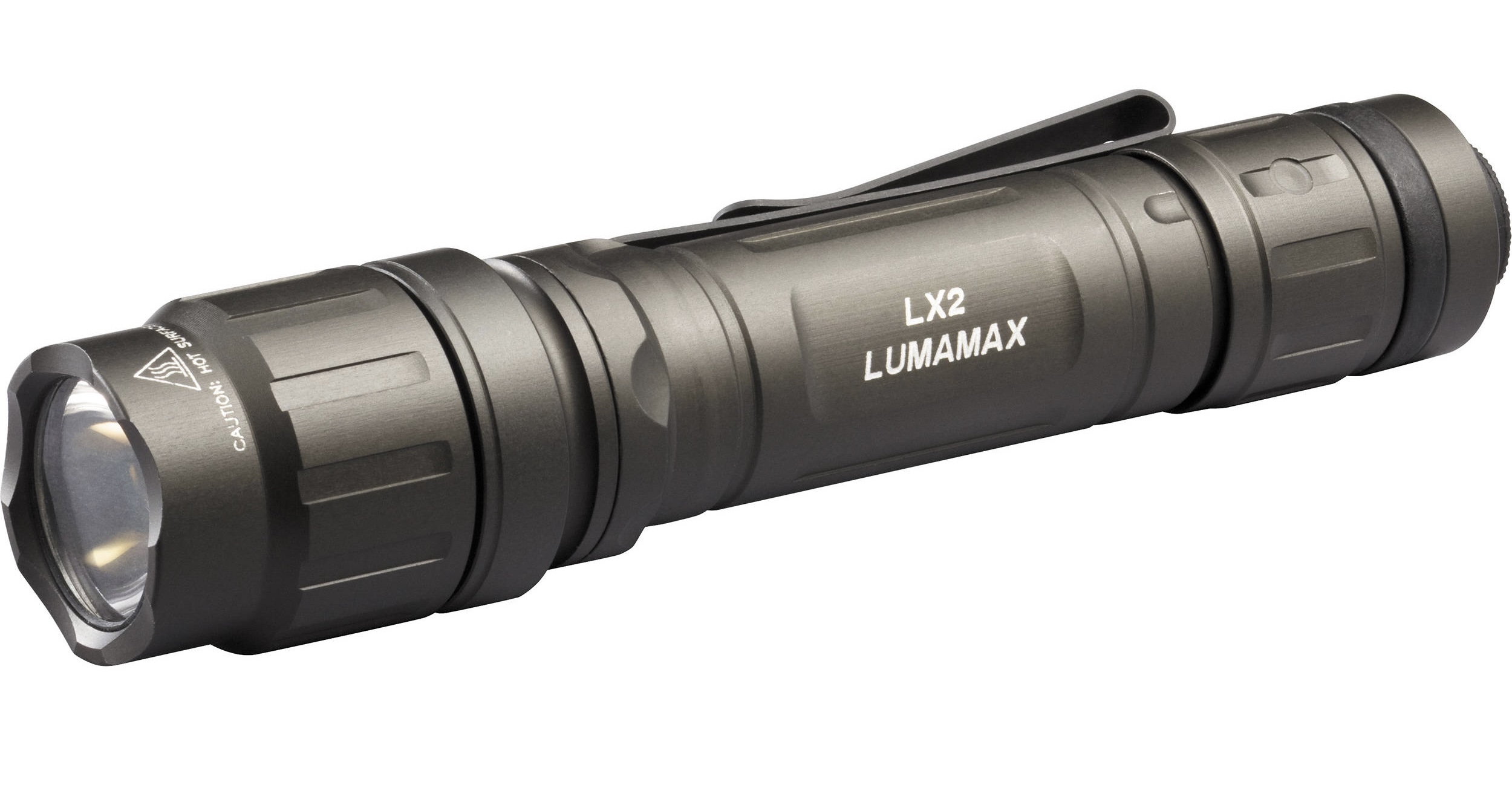

Been a Surefire fan for decades. My wife and I both carry on our key ring a Surefire E2D LED Defender. You never know how much light you’ll need until you don’t have any!
Bedside companion!
In addition we each keep one of these in our nightstand.
