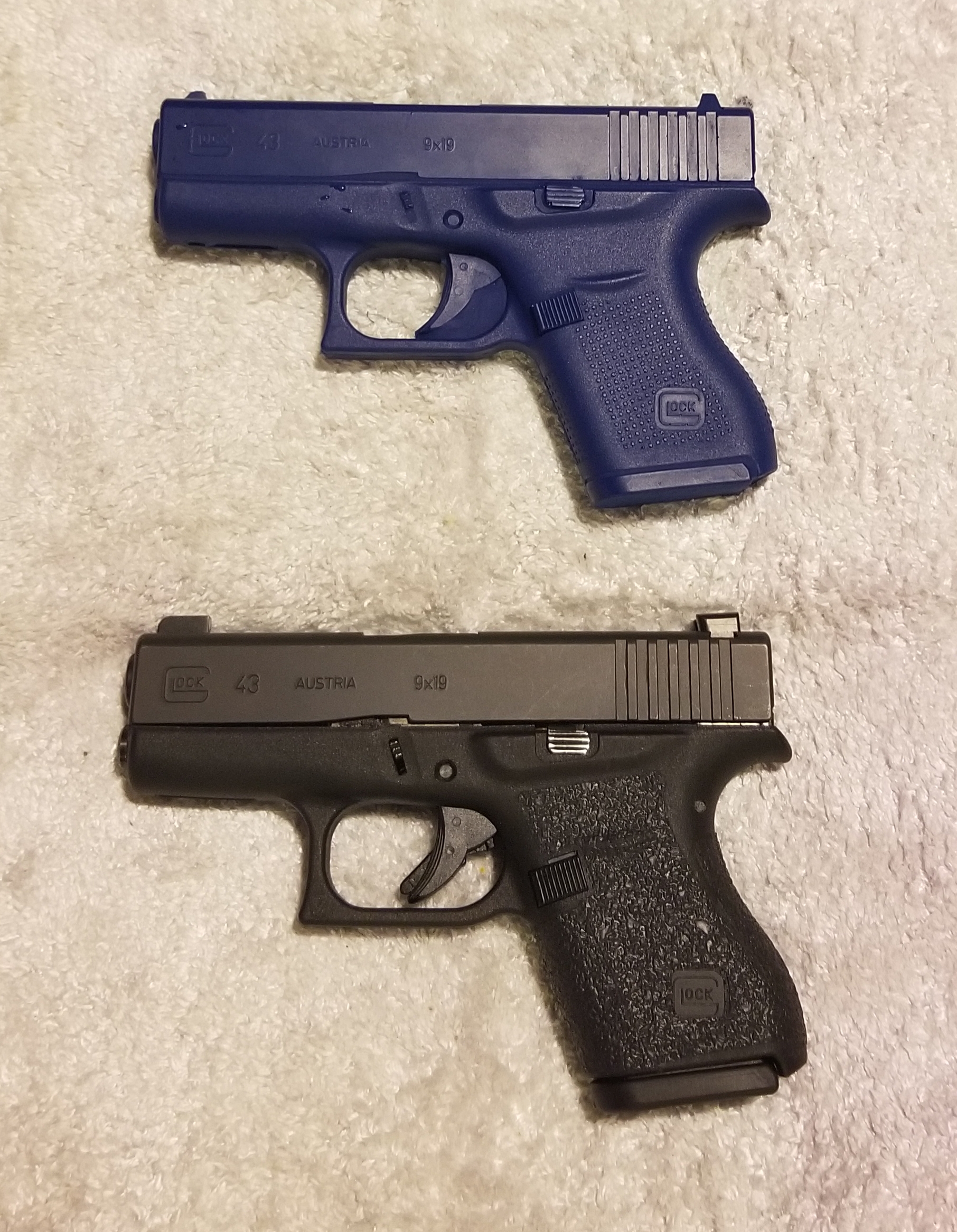

I have a leather OWB holster that I keep an exact Blue LEO replica of G43 in in when I am not using it (which is not alot) Over time the leather holster formed perfectly to the weapon.
