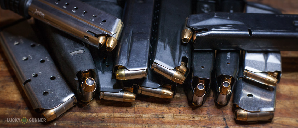

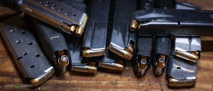

This guy addresses this topic in a rational manner:
