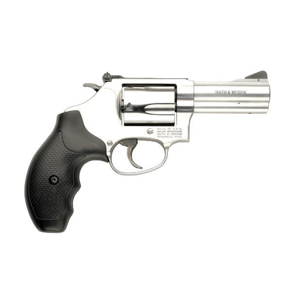

Not a problem with this gun … Always keep it fully loaded.
