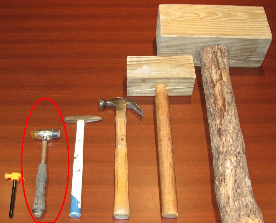

You really don’t need this :point_down:
Screenshot from 2023-10-01 20-34-14
to fix the simple issue…

The picture made it clear… :wink:
