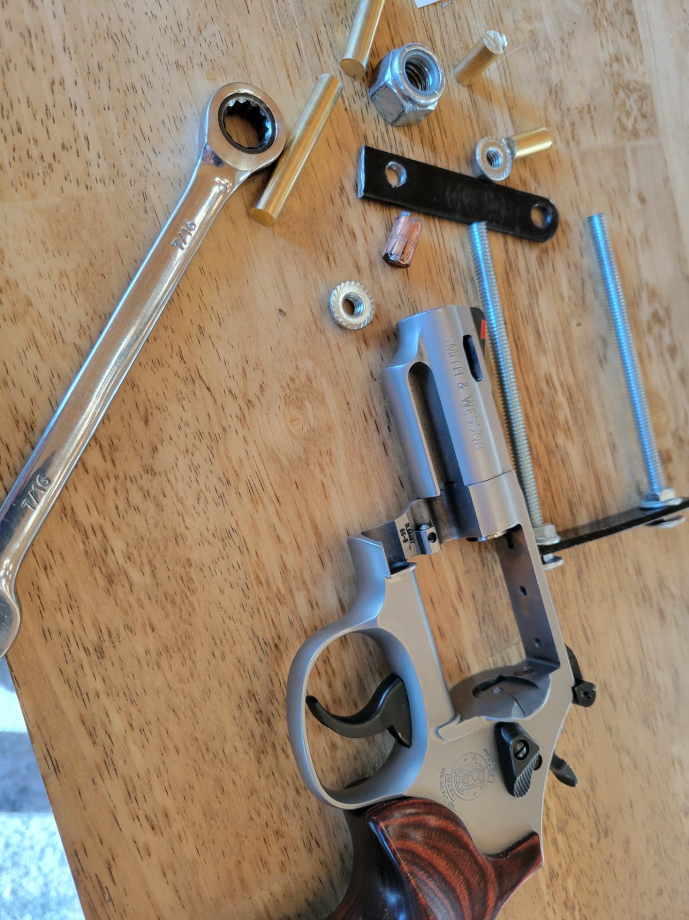

I got the squib out thanks to your idea about the nut on the barrel. I fashioned a homemade press and pressed the squib out with 8 mm brass rods and a Rube Goldberg apparatus that pushed the bullet out into a large bolt.

That was a very ingenious method - well-done. I am glad you were successful.

Nicely done.
@Mark697 Good job, glad you DE-SQUIBED! :wink: :+1:
I am glad your revolver is undamaged, and am curious if a pro gunsmith would use a press contraption, or opt for the propane torch. If you have a chance to speak with one, please share the conversation.
Wow, cool to see you got it out. Definitely some outside-the-box thinking but I’m glad it worked.
