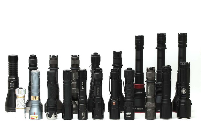

If you like spot beams, you might look at some of the LEP (Laser excited Phosphor) flashlights. They are the latest technology, but are not yet ready for prime time in my opinion. The strongest ones will throw out to over FIVE MILES, and can stay on at relatively high intensity for hours!
The problem is, these beams don’t widen out very much at all. When they come up with suitable diffusers, LEPs will REALLY be bad ass. They have come out with LED/LEP hybrids to try and address this issue.
Here are just a few, with better ones coming out all the time:

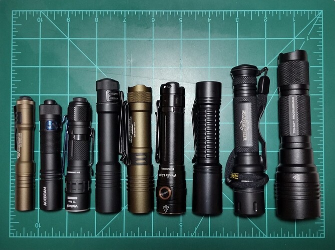

Received the Malkoff items. Tested both the Bodyguard and E2 Hyper Throw heads with a 14500 that is rated for higher amps. Here’s some other flashlights for size comparison:
From left to right: SL Microstream USB, Acebeam Pokelit, Weltool T1 Pro, Macrostream, SL Protac 1L-1AA, Fenix LD30 (18650), Malkoff E2HT with AA/14500 body, SF Tactician, SL HL-X.
