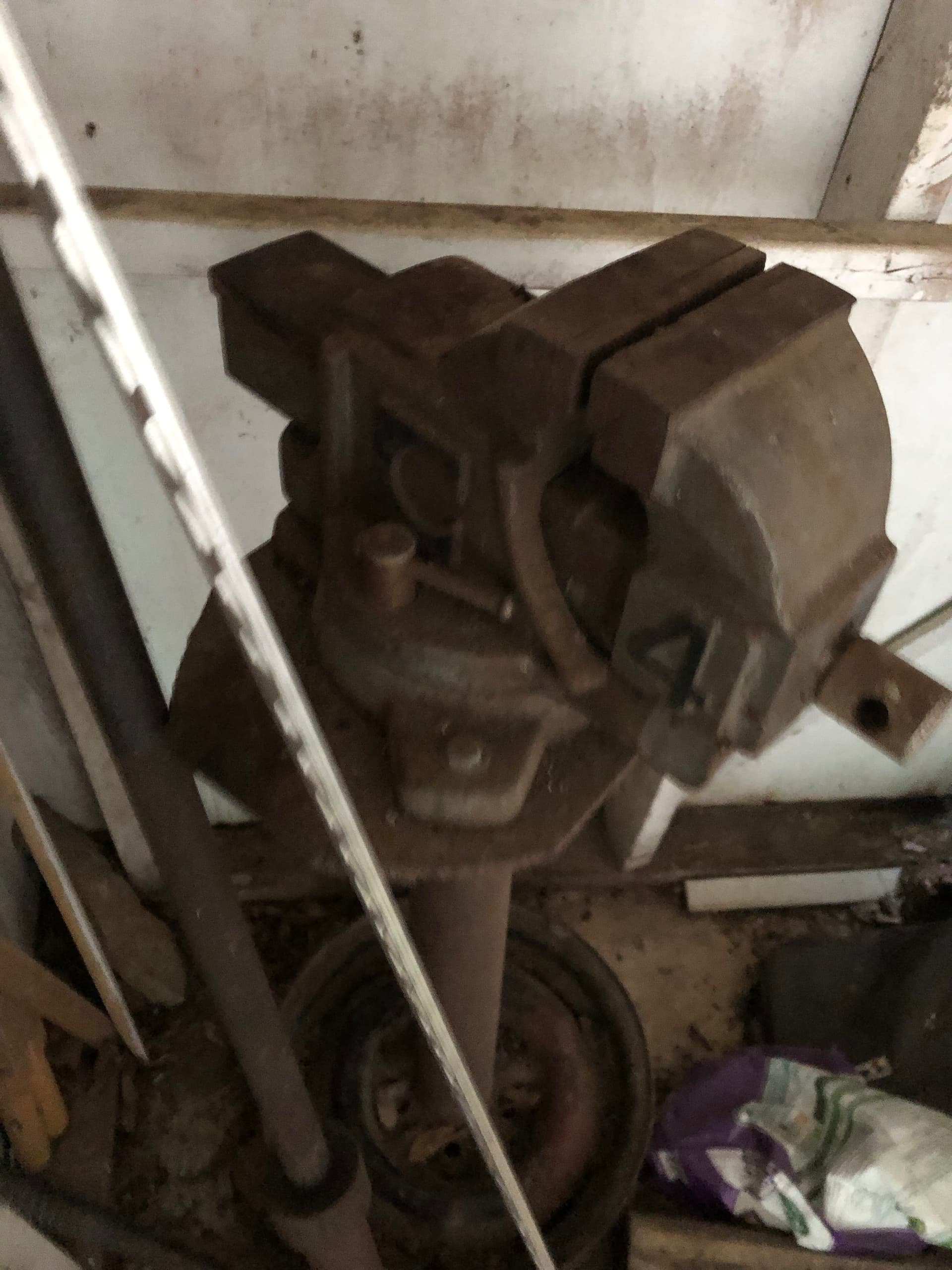

Just found an old vice in my back shed. The previous owners left it. I might try to clean it up that way I can just use my punches for sight swaps.

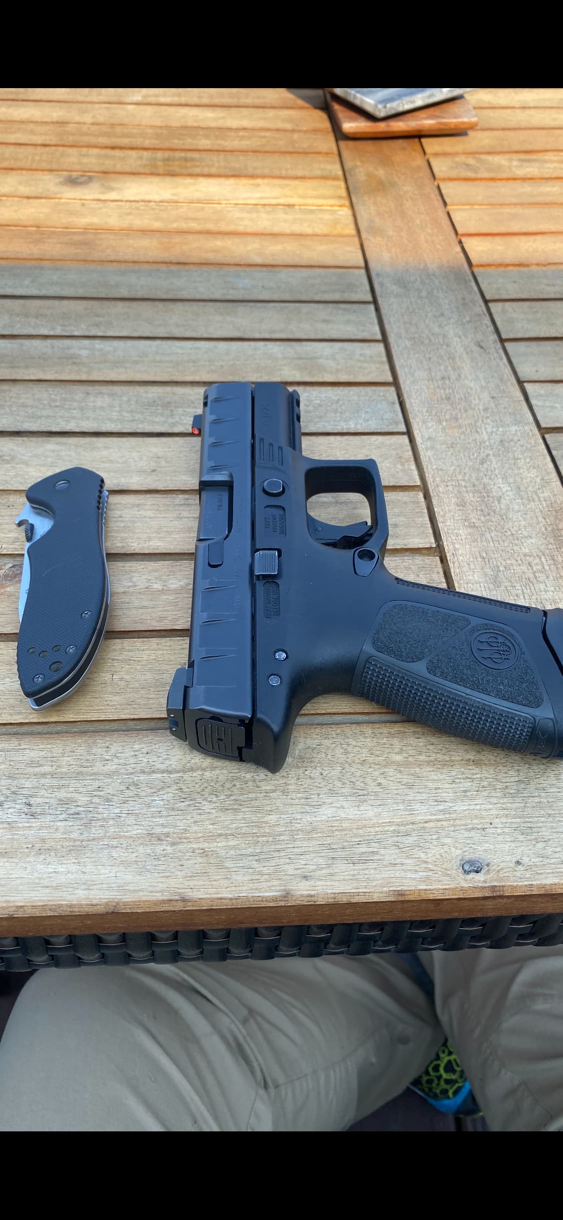

@Owen2
The knife on the table looks familiar is it the Kershaw Emerson with the USCCA engraved on the blade? I love mine brother.
That APX Centurion looks more interesting to me than the knife… :star_struck:
