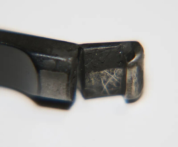

Pretty brutal on the extractor, but even if it snaps you will at least get one shot off.
Now that’s funny! :rofl:
I’ve been doing this for a long time, so not advising others to follow my lead, but I get get one draw from the holster every day as a bare minimum. That draw happens with a round chambered when I am getting ready for bed. I draw from the holster with discipline to keep my finger off the trigger. I put the gun down pointed in a safe direction, remove my holster and put the gun back in the holster - being sure the trigger has no chance of being pulled during the entire process.
Gary_H (!) That’s a point. I am unaware how that practice affects the extractor. Please tell me more! (Thanks) If that IS a factor, I’ll load the chamber from the magazine, than drop the magazine, top off and place it back in.
A good way to think about it is these firearms were designed to have the slide/bolt pull a cartridge off the top of a magazine and slam it into the chamber. That means parts (like an extractor) are designed to impact certain things (like a cartridge) at a certain angle and a certain speed.
Anything we do outside of that normal operation “can” cause issues. Maybe its the cartridge not being chambered properly, or the slide is maybe slightly out of battery, or in some cases damage to the firearm (like an extractor). Is it going to break the first time you do it? Probably not. And some firearms are more susceptible than others. But for something you want to guarantee that it works when you need it to, it’s best to just use as the manufacturer intended.
Piggy-backing on what @Harvey said, the cartridge is moved forward by the breach and slides up under the extractor as slide moves forward into battery. From my perspective the extractor has two jobs. The first is the one we are discussing which is to help hold the cartridge up while it is in free space prior to hitting the feed ramp. Hitting the feed ramp is where the bullet setback occurs. Its second job is to “extract” the spent case from the chamber and hold onto it until it hits the ejector. Rinse and repeat.
The extractor, whether external or internal to the slide, is spring loaded. I’ve never seen one that didn’t have a curved feature on the front to help it jump over the rear rim of a cartridge in the loading scenario you described. That said, it is a risk I am not willing to take with life support equipment. Here’s a couple of photos I found on the internet:
It was pretty funny, at the range. Wouldn’t be in a self defense scenario. :flushed: Needless to say, after that wake up call I started doing a lot more draw practicing to “overrule”, if you will, that nightly habit.
