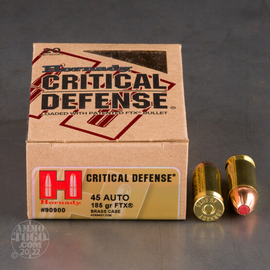

If anything, in a new 1911 a break in period is warranted. You would more likely experience a FTF rather than a failure to eject, due to the nature of a “hollow” point. That’s from experience!
These failed to feed through my 3” 1911
But these had no problems after break in. Are now my EDC.
