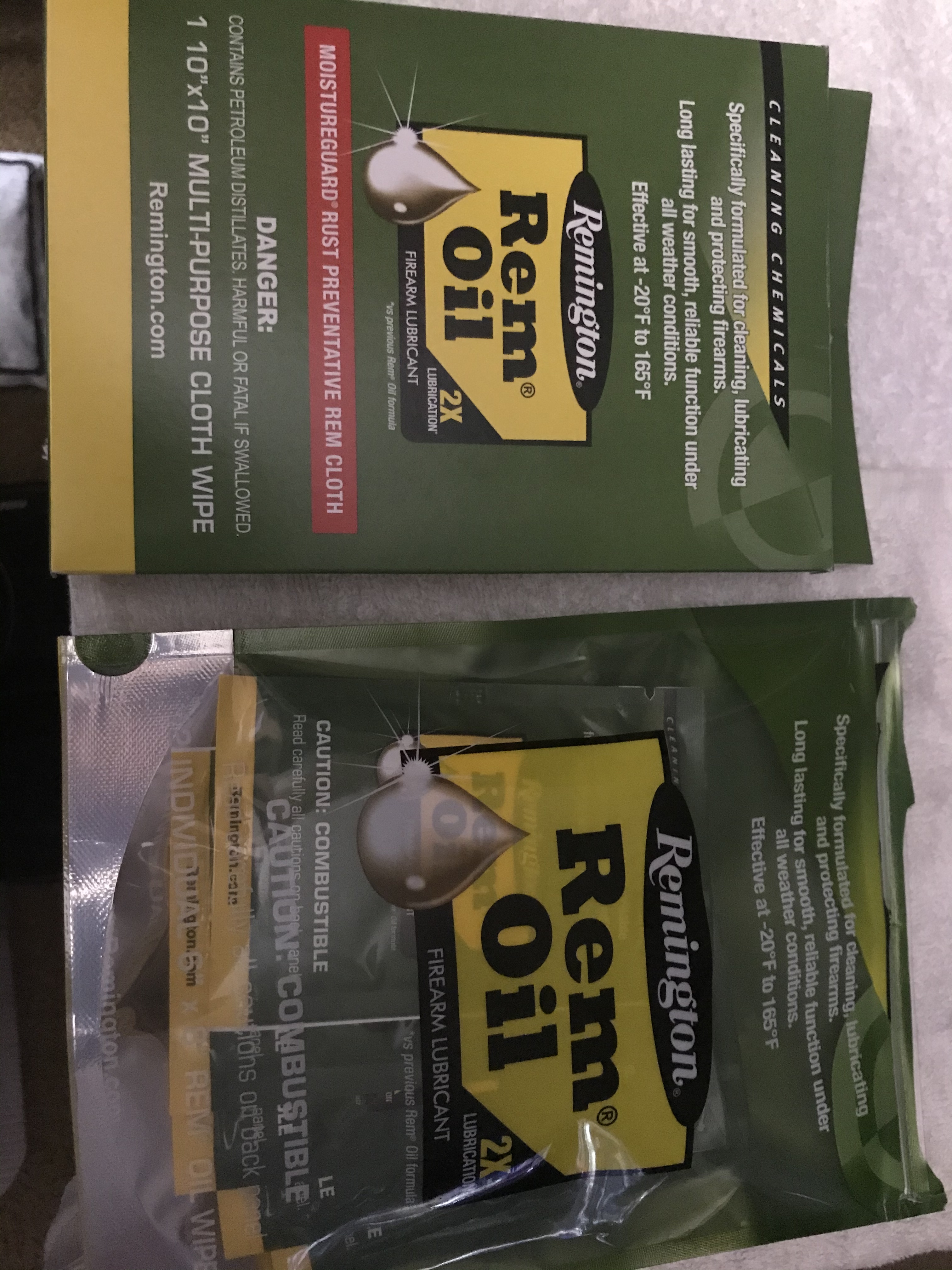

Hey brother I don’t know if it will work on rust that’s already there or preventing it from rusting. But I wipe my firearms with this to prevent rust, hope it helps brother. Be blessed.
I’ll try anything a few times. Thanks brother!
