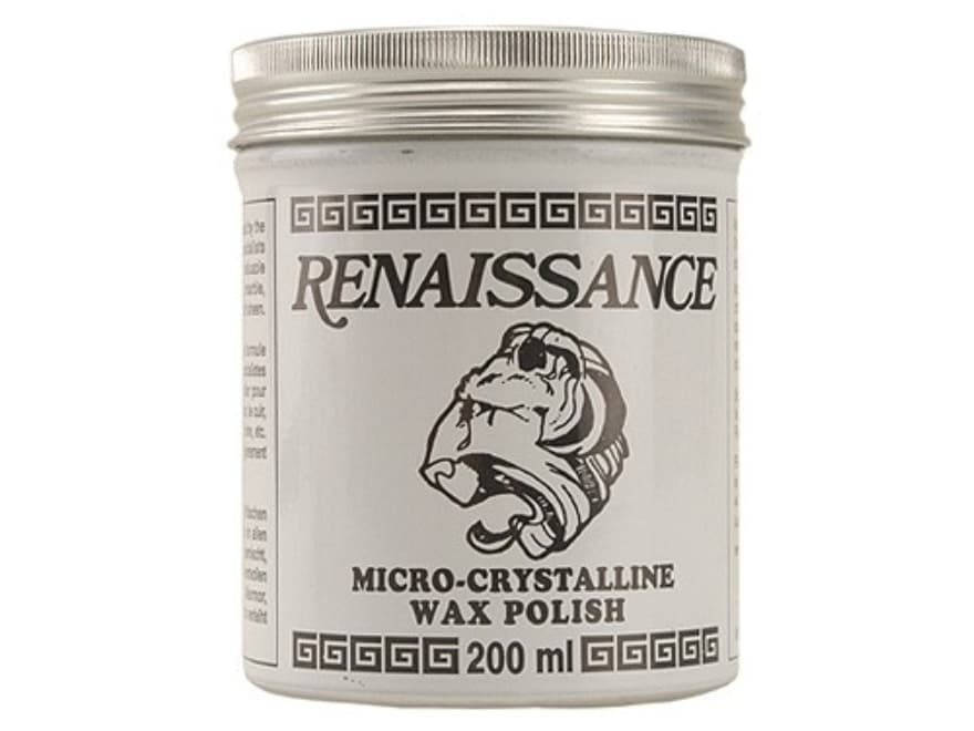

For the metal on the outside/external parts, after I wipe with a thin coat of oil I use this wax:
Using this product, when my EDC was unattended for a while, when the patina started, I just use a cloth and it wiped off easily, I noticed the patina never sticks or takes, so I figured the wax helps combat its sticking. The wax had a slightly bad odor when applying but it quickly faded away, it only takes a light coating. That jar lasts a long time. Keep jar zip-locked double so it lasts long and does not dry out.

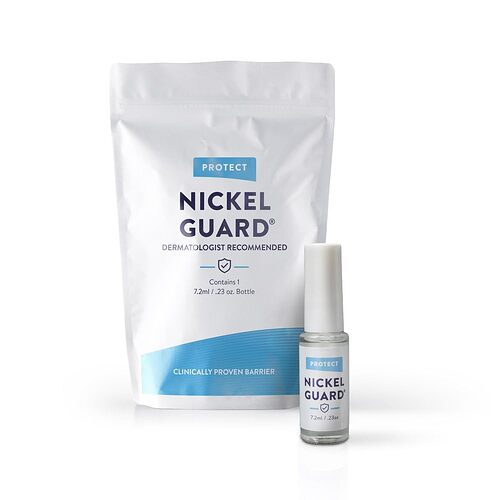

Question: For my revolver. I don’t like the patina getting on my ammunition, especially when it’s inside my EDC’s.
I don’t have issues with the ammo on my semi auto.
But for my revolver, I really like the ammo, so I don’t want to change brands. I know one only needs to inspect the ammo and wipe it down once a week. But in trying to combat it, I was thinking of wiping down the ammo in my EDC with a protectant, only on the casing, such as the brass.
I was thinking of using a Jewelry product they use to protect from patina forming.
Any of you have ideas on how to reduce patina from forming on ammo, or ever applied products to the ammo?
Figured, if I use it, I’d fire a a full cylinder round to see how it performs to ensure the casings don’t get stuck in the cylinder.
I wouldn’t risk using this product on my semiauto, as too risky inside a magazine, for my semiauto, I just wipe clean my ammo more often, but generally do not experience rust as opposed to my revolver.
I notice the patina rarely ever forms on the rear.primer area, so I’d avoid applying any product there - figure it’s a more sensitive area anyways, thus thing more about protecting the casing.
Nickel Guard - Protective coating for metal objects:
This ![]()
