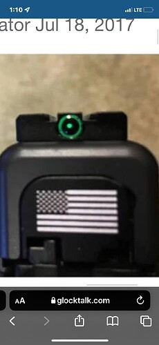

This is where point shooting comes into play so if you own a striker fired weapon you can pot a dot color of your choosing in the middle back plate of your pistol use in conjunction with a blacked out rear It’s for repeatable point shooting where target is under 5-7 yards wile back of the gun is used to sight in in an instant just try it with a lil stick on dot first once all fundamentals are followed proper grip level hold on weapon, slide parallel to the marching surface . Trigger control. You should be able to place 3 center mass shots on a target I say three because you need to be moving and not stationary either finding cover or adding seconds by moving out of line or just not being a sitting duck
A lot of conventional thinking will suggest putting that bright dot on the front instead of the back — since your hand already knows where it is, and it’s the muzzle which needs to find the target.
But testing various temporary adjustments is exactly how to find what works for an individual. This one is cheap and easy. Changing guns, or red dot vs irons, is considerably more hassle.
It’s a point shooting technique most special forces use target are very close basically wet works close no time for sights the only thing you see is the dot hazy. Front sight is usable up to infinity but your focus may wane it has to do with gross motor functions when people do it it clicks but all other factors play as well
That’s an interesting concept. As I sit here with a SIRT it kind of seems like I could “point” a dot on the backplate somewhere very different from where the muzzle is pointed pretty easily.
Typically threat forward of the muzzle pistol is threat centered. Threat is 6 yards or less weapon is up high with sights aligned you are using the bore axis as your sight Stick a pencil in the barrel and see what I mean it’s for close range not typical distances both eyes open. You have the sirt tape a dot ant point at a close target use your sights as you would at nominal distances it’s for super high stress gross motor functions where trying to focus on sights can get you killed. Ask the seals that use it they know more than I care to say.
Think this sight except super simple note fundamentals come into play like lots of practice with the same gun and drills over and over
