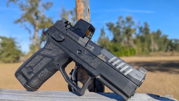

The OSight sits impressively low to provide co-witness with most handguns and standard height sights. If your gun forces you to remove the rear sight to mount an optic, a small notch allows you a functional rear sight.
We get ten brightness settings. Two are night vision compatible. The optic comes with shake awake technology that automatically shuts off when it doesn’t detect movement for 3 minutes and turns back on when it moves again.
The new Osight SE ditches some of the downsides I had with the older model

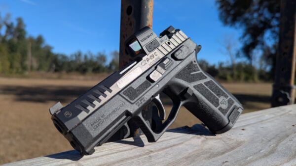

Two buttons control the brightness levels, the reticle swap, and the on and off functions. It’s simple to use and intuitive to install. I installed mine on a CZ P09 Compact.

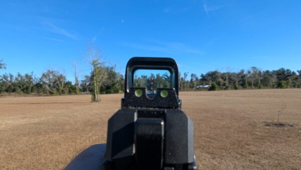

The OSight SE doesn’t suffer from the same problems as other budget enclosed emitter optics. It gives you a fairly clear view with only a slight blue tint. It’s nice and clear with good light transmission.
The dot is crisp enough. It’s not going to be mistaken for a higher-end optic. It starbursts a bit, but works well. In varying light conditions, especially under weapon lights, it works without issue. You can find a brightness setting that works well in both low and bright light without much difficulty.
For an eclosed, budget optic it’s surprisingly clear.
With light facing you from multiple directions, I didn’t notice any serious reflective issues. With the sun in front of the optic, there was some reflection, but nothing to make the dot difficult to use.

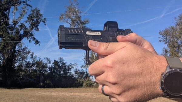

With that said, I mounted the optic on the P09 and got to shooting. Zeroing was easy, and the turrets provide good feedback with every click. A 15-yard zero was done in nine rounds, and I was scoring tight groups. Sticking to close range, I fired a 10-10-10 Drill, a Bill Drill, and a failure to stop drill.
The dot’s refresh made sure it didn’t lag and became a nice red blur. This made repeated hits easier and allowed me to track the dot between shots and watch it settle right back down on target. Rapid-fire strings of fire were easy to accomplish with solid accuracy.
