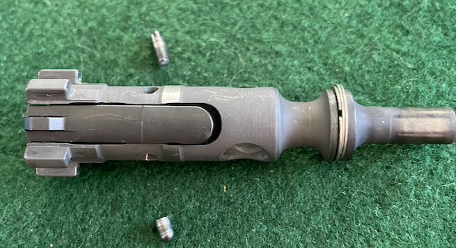

I then proceeded to break it down for cleaning. The Ejector Pin came out in two pieces.
Everything else looked normal, so I am sure that was the problem. I had a spare ejector pin, so it is now repaired and manually cycles brass normally, so it is ready to go back to the range.
