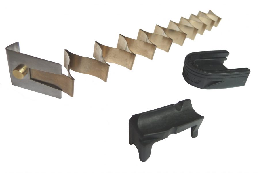

Mag guts ( Increase your magazine ) ADD MORE CAPACITY…..NOT MORE SIZE!
Has anyone tried this? , what’s your thoughts on this.

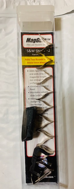

I did order the mag guts parts yesterday, so when they come in, I’ll install them and try it at the range. I’ll give an update on how it worked out.

I received my parts today, I will install them today and try it out at range here real soon.
