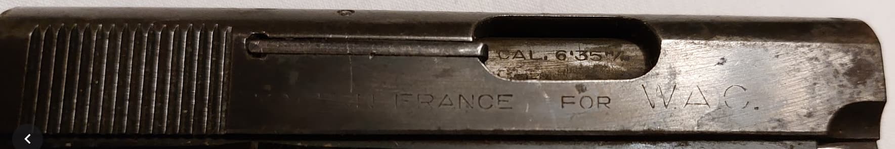

MAB is Manufacture d’Armes Automatiques de Bayonne
WAC is a U.S. importer, Western Arms Corporation.

Looking at the picture of the left side of the slide, it appears to say it’s a .25 cal. I think you’re safe as .25 is a centerfire cartridge.

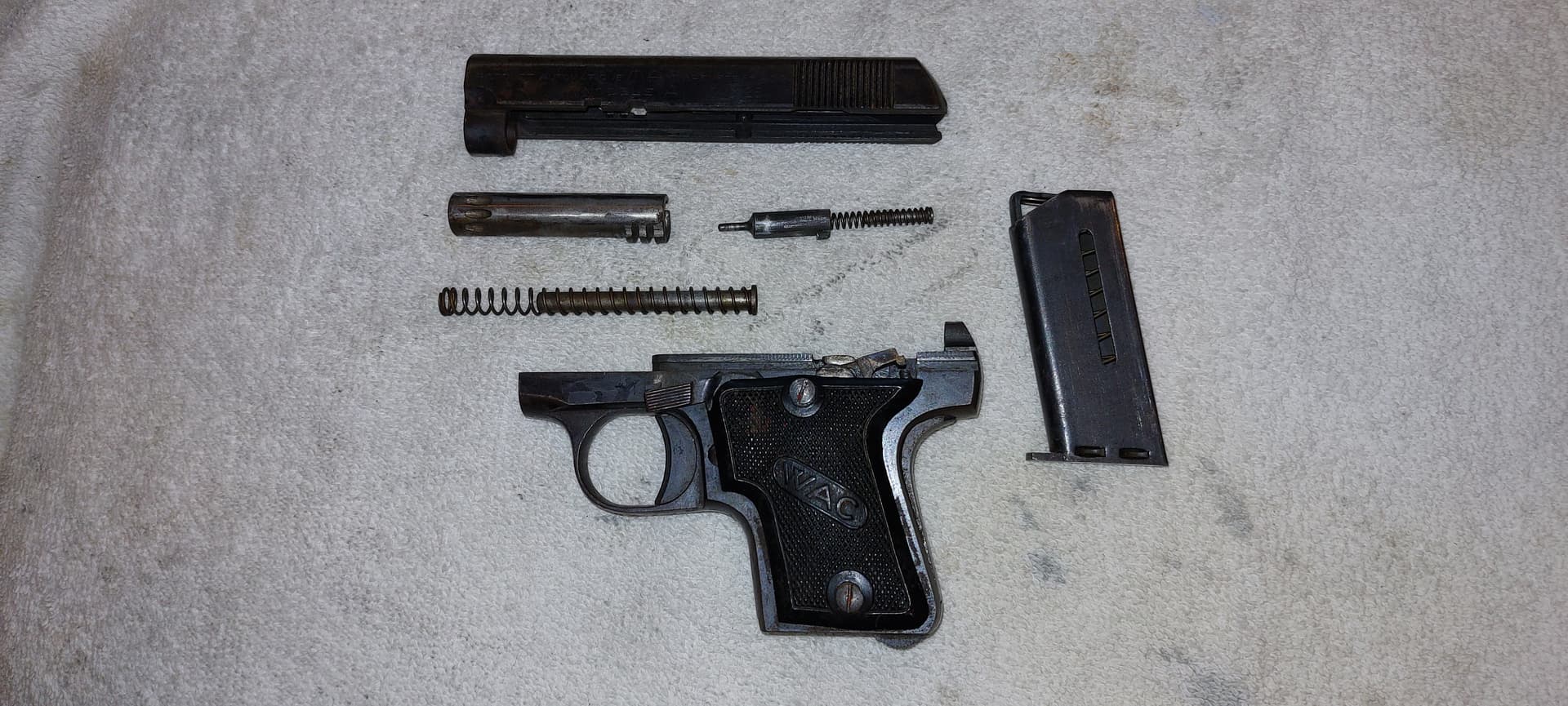

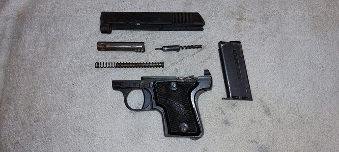

Yes, I have it partially disassembled now. The field strip instructions said to dry fire it take it apart, so I did measure the trigger pull. It runs 11 to 18 pounds depending on how high or low you are on the trigger.
Kind of odd the magazine release is on the bottom rear of the grip. The magazine does not fly out on its own :grinning:
The chamber and bore initially looked pretty discouraging :-1: A cartridge went less than half way in on a plunk test. A look down the barrel was a complete black out. After some chemicals and a lot of elbow grease, the chamber passes the plunk test :+1:
Now that I can see down the barrel, it looks like it has not seen very many bullets down the pipe! Not surprised considering the intended purpose of this design.

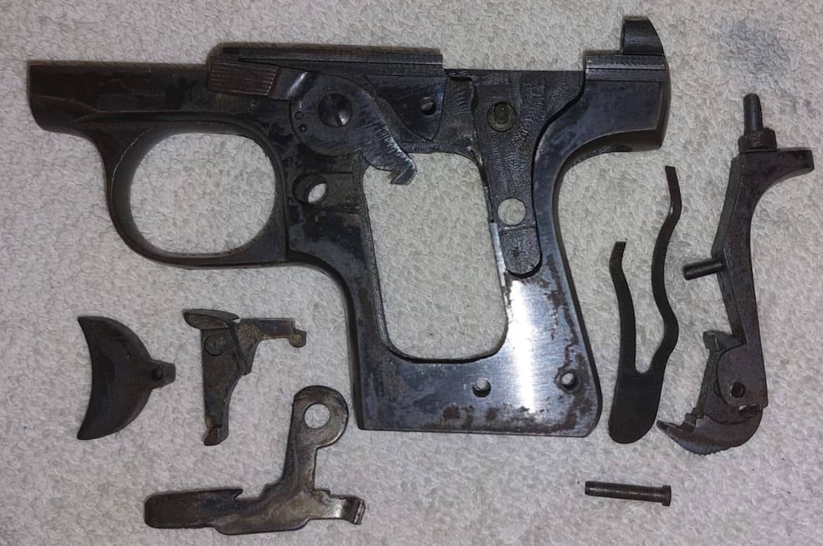

That was a good call Bruce :+1: Every thing came apart very easily today. After dissassembling the trigger group parts, I don’t think I am going to be able to resist cleaning and polishing some of the internal parts to make it work smoother. The only parts that are clean and shiny are the sear and striker interfaces! I will be leaving those alone.
I’m glad it worked. From the looks it needs some polishing, A Dremel with cotton tips and polishing paste. I like to bring “old things” back to life to. :slightly_smiling_face:
A light coat of oil on all the moving parts when you’re done wouldn’t hurt either.
