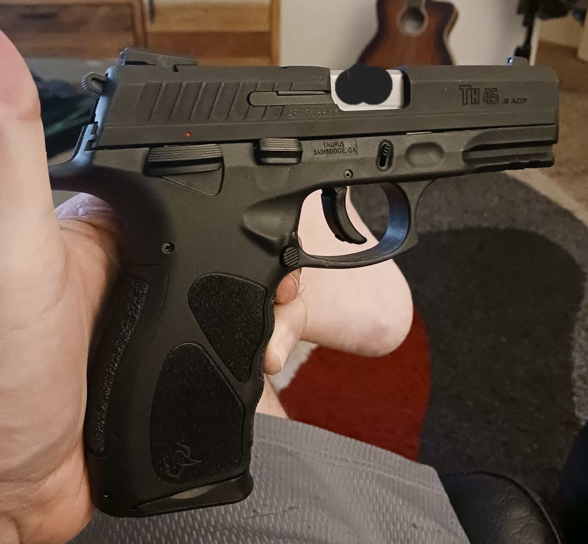

I have a Taurus TH45. It has a decocker. After the hammer has been decocked you can either pull the trigger using double action, re-cock the hammer manually which makes it single action at thst point. While shooting the pistol, much like a 1911, after a round is fired & the slide is actuated, it is always single action unless you use the decocker to lower the hammer. The lever by the hammer is the decocker. By pushing it downward, the hammer will fall & the gun is decocked. Pull the lever up (over the red dot) and that is your manual safety if you choose to use it.I hope this was not too confusing. BTW, I really love ths pistol. Ive put hundreds of rounds through it & it eats everything. Easy to disassemble/reassemble. The only thing I don’t like is the mag release. It is difficult
