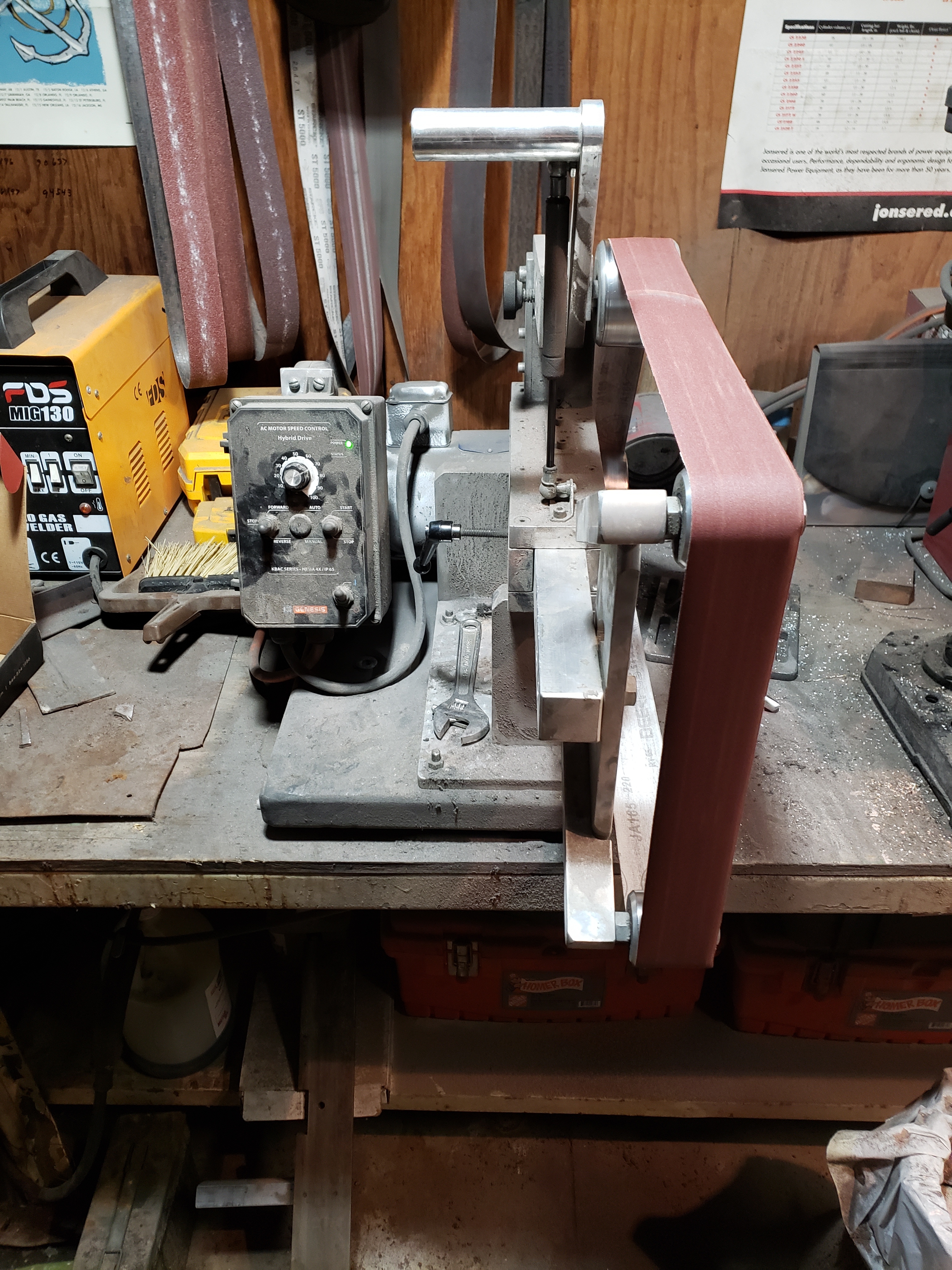

Oh boy, I oil them when they don’t open snappy enough, and I sharpen on my 2x72 belt grinder with 120, 400, and 1500 grit belts everytime they get too dull to shave hair (I have a 1940s style pinup girl tattooed on my left forearm that has no hair on her arms or legs :joy:). I also have used the Work Sharp belt system and that’s super handy as well.

Just when I get it. I wouldn’t recommend doing it on knives with steel types that are questionable or unlisted. This is my 2x72 belt grinder that I sharpen on. 20190404_151849

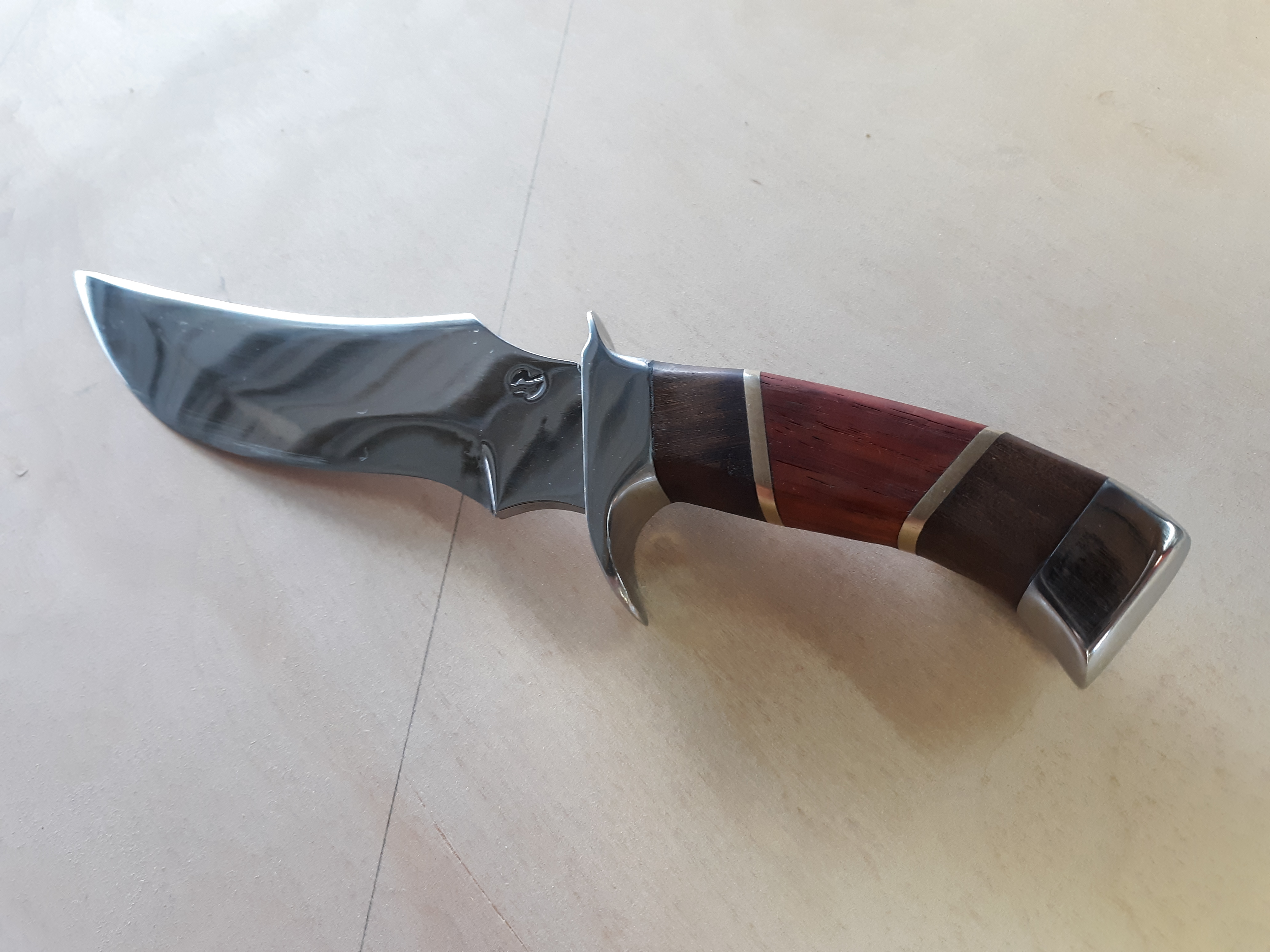

Just finished a new carry knife for the field. I’m going to make a mini of it for EDC. Thought y’all would enjoy…
