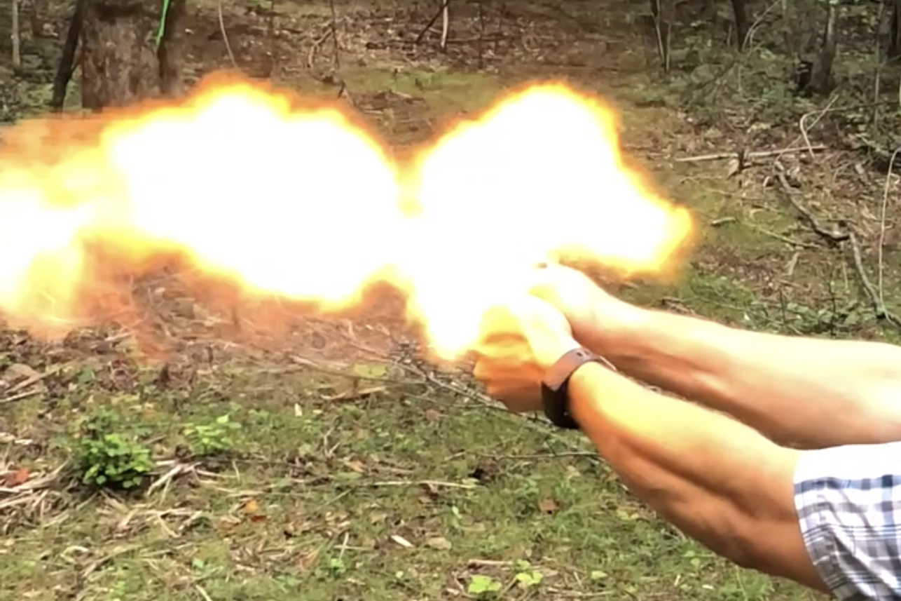

I thought I’d open a discussion on low light shooting and the experiences most folks have when shooting their “training” ammo in low light versus their selected carry ammunition.
I’ve shot my .357 SIG training ammunition (Remington green & white) in low light and the flash was bright enough to, IMHO, delay requisition. However, I plan to try other different manufacturers of carry ammunition and see if the flash is reduced.
And, for those of you who somehow found my post worth reading to the end, that’s my .454 Casul Ruger Super Redhawk.

I really want to do a low light shoot with my full size 1911 and my Officers model AND my LAR Grizzly in 45 WinMag to show the muzzle blast from each. Hoping for November when a bud of mine is coming down for a week of woods time. That said my 3.5" Officers model with full house 45 rounds is a bit bright.

I’m reading your mention of my “conflagration” and it prompts me to consider starting another topic; an oft little-regarded difference between retention shooting of auto-loaders versus revolvers.
Also, thanks to you, page 150 of my Webster’s has seen daylight for the first time. Ahhhh - I love, love, love the smell of an old book!
@FarmerFrank I glad I was able to assist in Noah seeing a little daylight. I think If that had been a retention shooting scenario, the attacker would have been a smoking pile of ashes before the bullet reached him.
