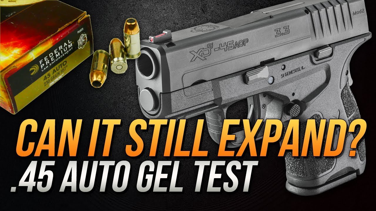

For the benefit of those not watching the link this is an Interesting comment and reply from the XDS 3.3" and 5" 1911 video:
The guy that made the video obviously thinks the HST does not perform properly in the short barrel.
Which video is that, what test was done on what gel and what were the penetration/expansion results with each?
I jumped through the one with a short barrel from AR15 .com and it performed ā€œlike a bossā€, perfectly, flawlessly, exactly as you want, even from the super short barrel. That was the .45. The ammoquest 9mm series also shows all HST performing exceptionally well, basically perfectly, from a 3" barrel (124gr mostly as I recall…really the answer to what defensive ammo should just be ā€œHST and be done with itā€ lol)
The Federal 150 gr HST is a good choice for sub-compact pistols,
FWIW, I don’t trust the clear ballistics gel, it’s not 1:1 with calibrated ordnance gel, though it generally seems IMO to show as the second best thing out there.
That is an unusual result also. First time I remember seeing an HST fail to expand. And it was only about 20 FPS slower than the long barrel. Like literally if I followed that correctly 3.3" was only 20 FPS slower than 5". I have a hard time believing 20 FPS difference on an HST accounts for massive expansion vs basically zero expansion. I’d also like to see more than three total bullets fired, the better tests do a minimum of 5 and then average them to account for outliers.
But, it did fail to expand from the shorter barrel, even with all of the limitations to the test listed above, that was the result. Maybe that’s one reason I don’t conceal carry .45 ACP, it doesn’t expand reliably from short barrels maybe? IDK lol

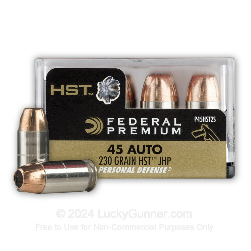

because their pictures are easy to link, here is lucky gunner doing 230gr HST in .45 out of a 3.6" barrel
That picture is a thing of artisic and engineering beauty. Lucky Gunner is simply terrific.
