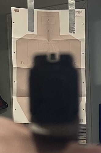

I have the Big Dot sights on my G30 and P30
And these on my G35
I can focus quicker with 2 dot sights but, with the 3 dot I can instantly see if I make any grip/trigger issues.

Have you played with the 2 Dot sight with its alignment to see if there is, let us say any play on the sights? Your dot size is a variant to the precision of your shot. How much does it cover on the target at 7 yards? What is the size of your dot?
The 2 dot, front sight(0.188)on the 8x12 target, covers a large part of the target.
