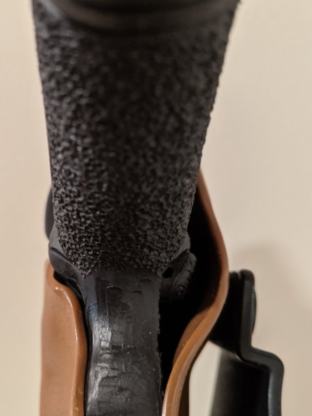

It finally happened to me, but fortunately not in a defensive use situation. When I took my holster off one night I noticed the magazine was not seated properly. Weird. Then it happened a couple of weeks later. Then I noticed in the holster (which I really liked and had been using for several months) the edge of the kydex crossed over the magazine release (i.e., didn’t fully cover it) and if I pressed right on the edge it flexed enough to eject the magazine. Damn. If the kydex extended another 1/8" to 1/4" this wouldn’t be a problem. If I’d had to draw my gun for a defensive use there is a real possibility I’d have had a single shot and then needed to do a reload. No backup mag and I might be toast.

Don’t get rid of the holster yet. Kydex can be reshaped easily by yourself. I’ve got 2 holsters that ejected magazines during draw stroke and I’ve fixed them in 5 minutes.
Kydex become flexible in higher temperature, so simple heat gun or keeping it over kitchen burner allows you to change the shape of holster for mag release button.

Thanks. The problem is I think, that I’d have to be able to stretch the Kydex rather than just reshape it. And even if I can stretch it, that would make it thinner and more flexible thus retaining the issue. #437 on my to-do list is contact the holster manufacturer, sigh.

You don’t need to stretch it, just create the space between mag release button and holster. That is the easiest fix and works perfectly.
I have to fight with this problem with most of my holsters. Some manufacturers just simply forget that mag release button can be on the other side of grip. Even you mark “left handed”, that usually means for them how to mount the clip.
If you fix it by yourself you will skip 436 other things to do :wink:

This is what I did with mine:

Trimming was hard for me. I don’t have good tools. After trimming you will need to smooth the edges and this doesn’t look pretty. Check my picture - I’ve tried to smooth the other side. It even started to discoloring.
The small change in shape I’ve done for mag release hasn’t change anything with hostler’s functionality - still the same retention and not different feeling carrying it.

Hit the spot up, press it out a little bit, cool off with water. You can do this dozen times, it won’t harm the kydex material.

I wanted to follow up. I was able to move the Kydex further from the magazine release, but that didn’t help. Because it is the edge it will still flex enough to press the release. I’m also getting into territory where I’m creating a gap that might allow access to the trigger guard. So I’m done, that holster is in the regrets pile. Looking at the picture you’d posted I think the kydex on mine is much thinner and thus has more flex, which is why reshaping didn’t help. I did compare it to another brand and discovered they bring the kydex all the way over the release to cover some of the grip panel. When you press on it the grip panel keeps it from flexing to touch the magazine release.
it may be a weak / thin kydex then. All my corrected holsters are still over mag release button and don’t touch it even squeezed.
You can use Dremel or other tool to just cut the piece of kydex which bothers the button.
