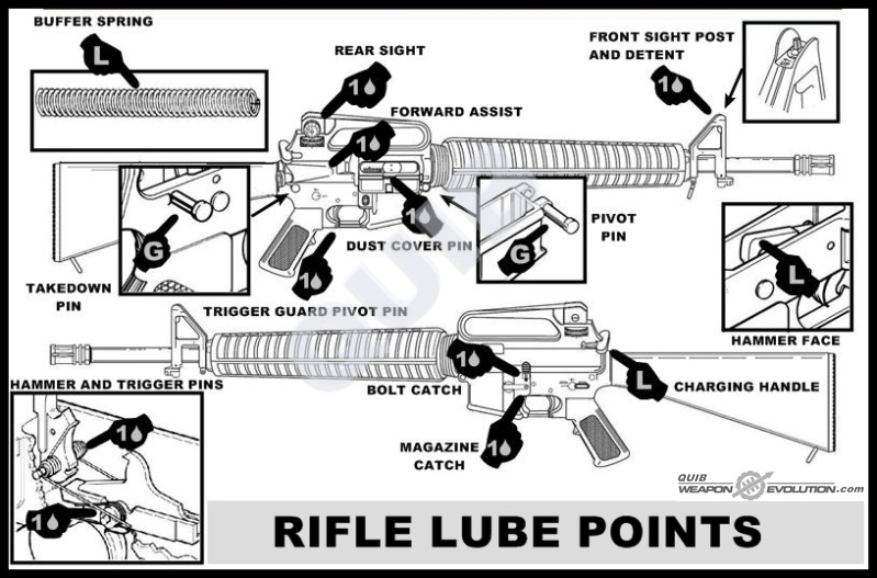

How do y’all feel about grease on the charging handle? I’ve never used grease, I’ve seen some issues with it before. BUT the charging handle looks like a good place for it.
You can try it if you like but in general if everything is lined up right the charging handle kind of just “floats” in the groove. The only real bearing surface is under where the gas key goes through and it pushes up against the BCG. I only like grease on parts that rotate or pivot around pins, simply because to make them work there is clearance and greaser stays better than oil on the rubby bits.

.i w ill tell you this first of all your AR should come with a manual (which i believe they dont) look up what ever you want to but .dont go and over lube the weapon .All you need to do is lightly lube the weapon I mean by maybe 3 to 6 drop of CLP or what your using. To put to much in is asking for trouble .They extractor be careful of it spring and pin if you mess the spring up you will buy a new one same with the pin dont lose it .As for this diagram on how to lube the AR-15 dont do it .After you clean it when you get it home.
