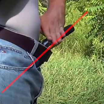

AIWB sacrifices 2nd safety rule by design. If somebody wants follow all 4 rules during carrying… appendix is not for him.
Even looking at the video, posted by @Gary_H
A 2023-08-23 07-12-45
there is no way we can achieve the goal without pointing the muzzle at the thing we would never want to destroy…
Practice makes everything fluent, proficient and effective. Adding safety features (manual safety) makes is secure, even it’s against safety rules.

That diagram exactly explains why I won’t appendix carry. If I’m in a fight, I’d rather not be the one shooting myself in one of the most important arteries in my body, causing near certain death.

It also seems to point the barrel right at the femoral artery. Where I place the holster avoids the artery and the most important part of my private parts. I may loose a testicle if something went really wrong but I’ve got a spare;)
