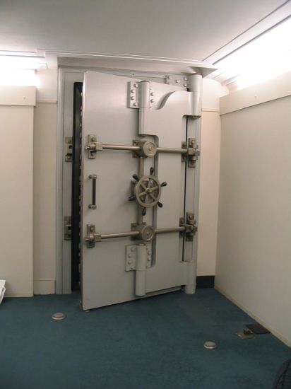

If things keep going the way they are going, because people are not stepping up, this will be my new front door
First, they are releasing all prisoners, locking people in their homes, and destroying livelihoods daily, then , “no joke” the demented one is coming for our guns!
Seriously if the door thing doesn’t work out. I’m definitely price shopping this baby, in silver of course
Love the belt fed loophole
