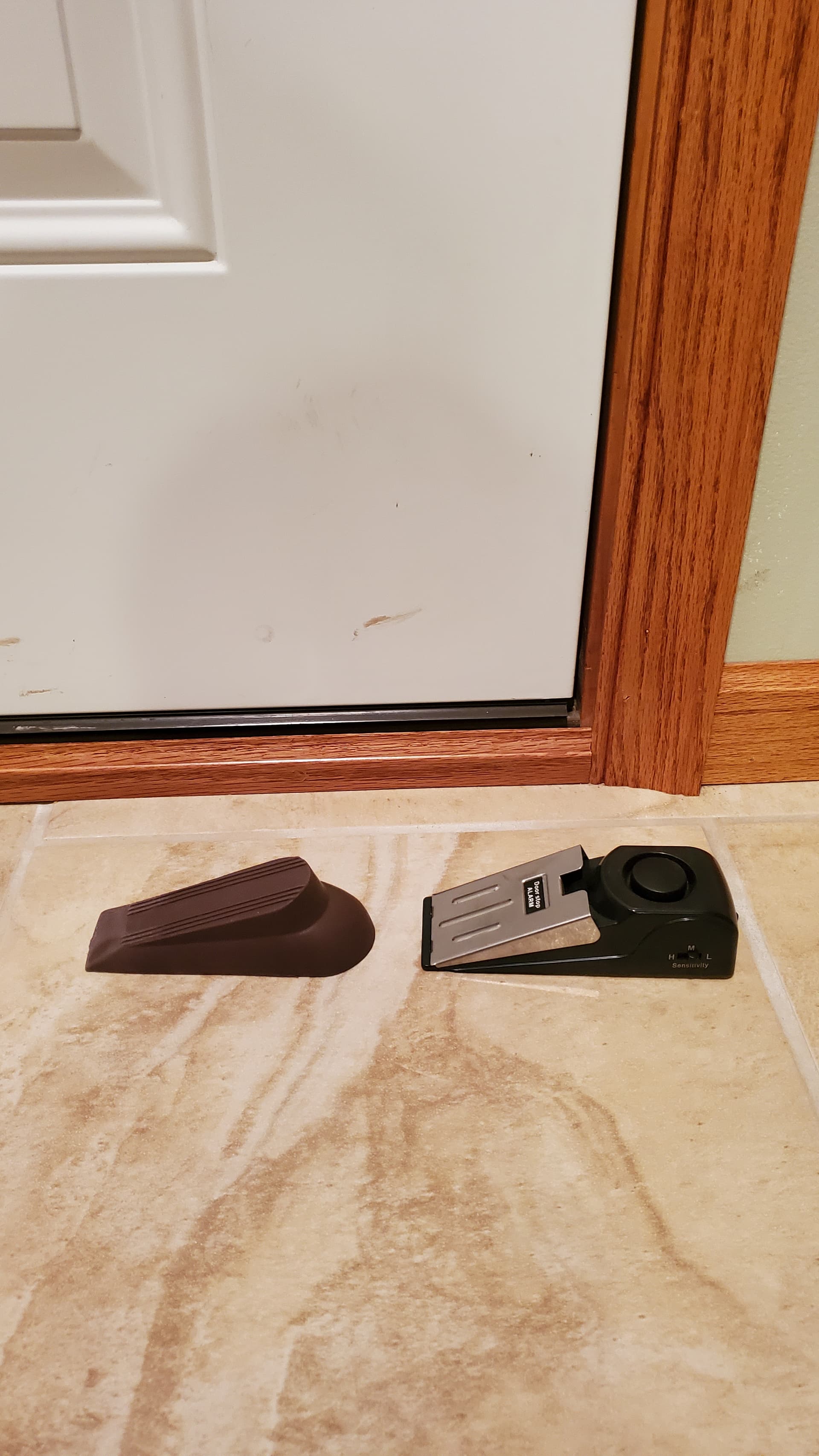

I like the idea of door stops with alarms, as an added alert. It can definitely give you another level of and advantage, but can also deter anyone who may wish to come into your home and steal or do you harm.
I have the alarm door stops on the right, they work well if your door is close to the floor.

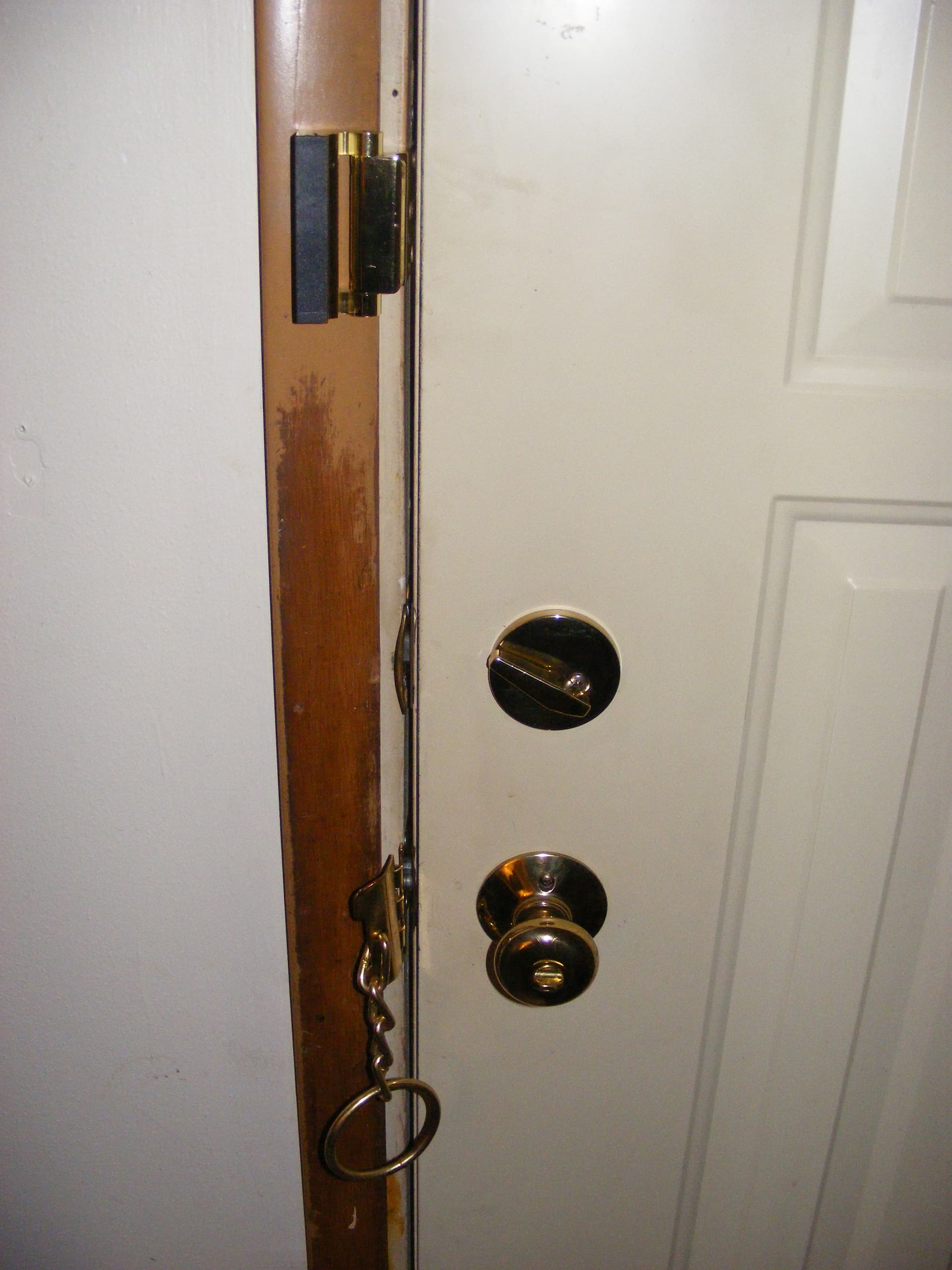

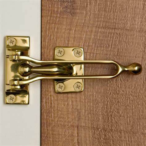

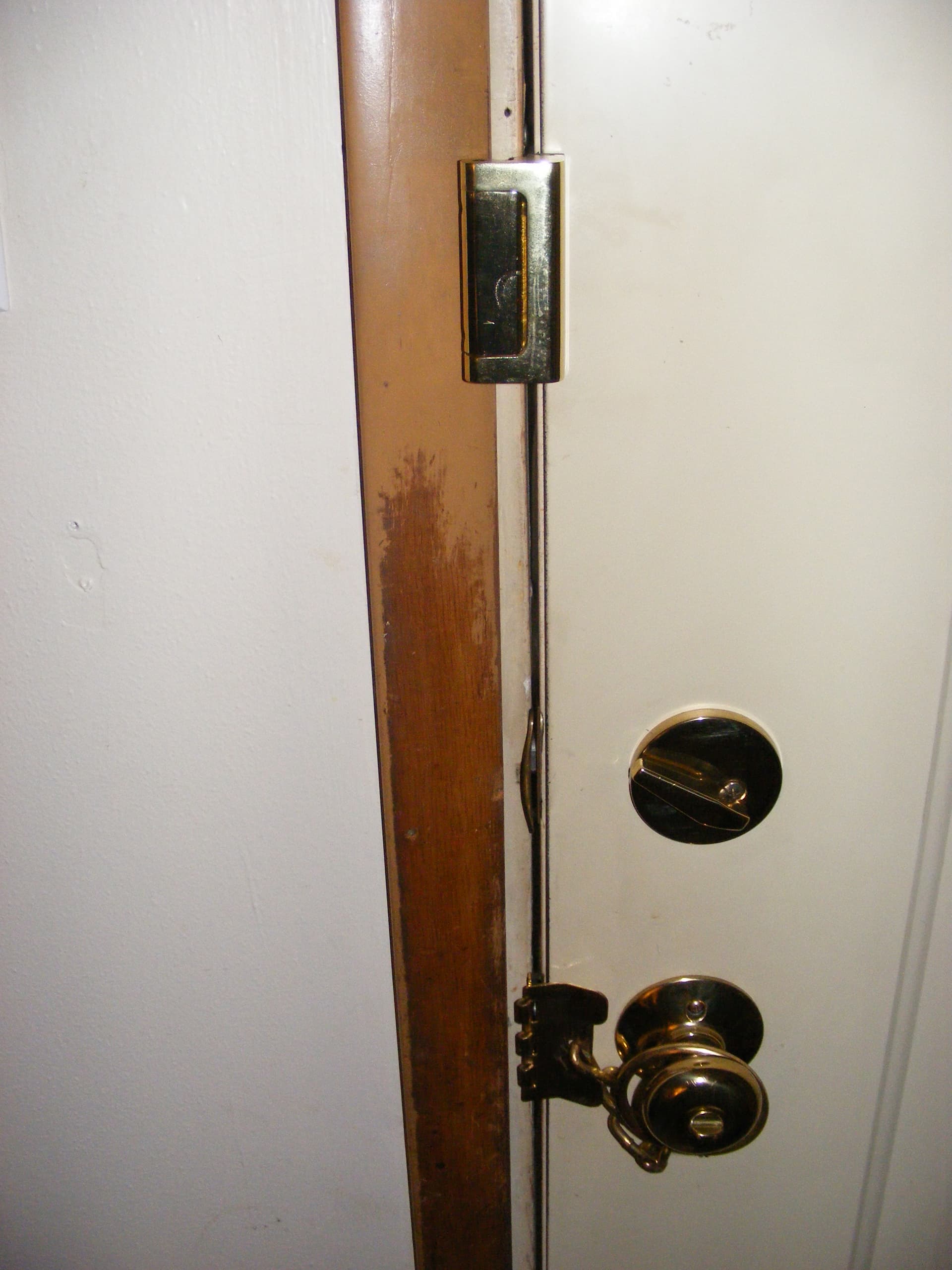

The two pics is how I have ours set up, the ring can be put on before you open the door and the one above the original locks is a strong backup, all have 3 1/2in. screws.

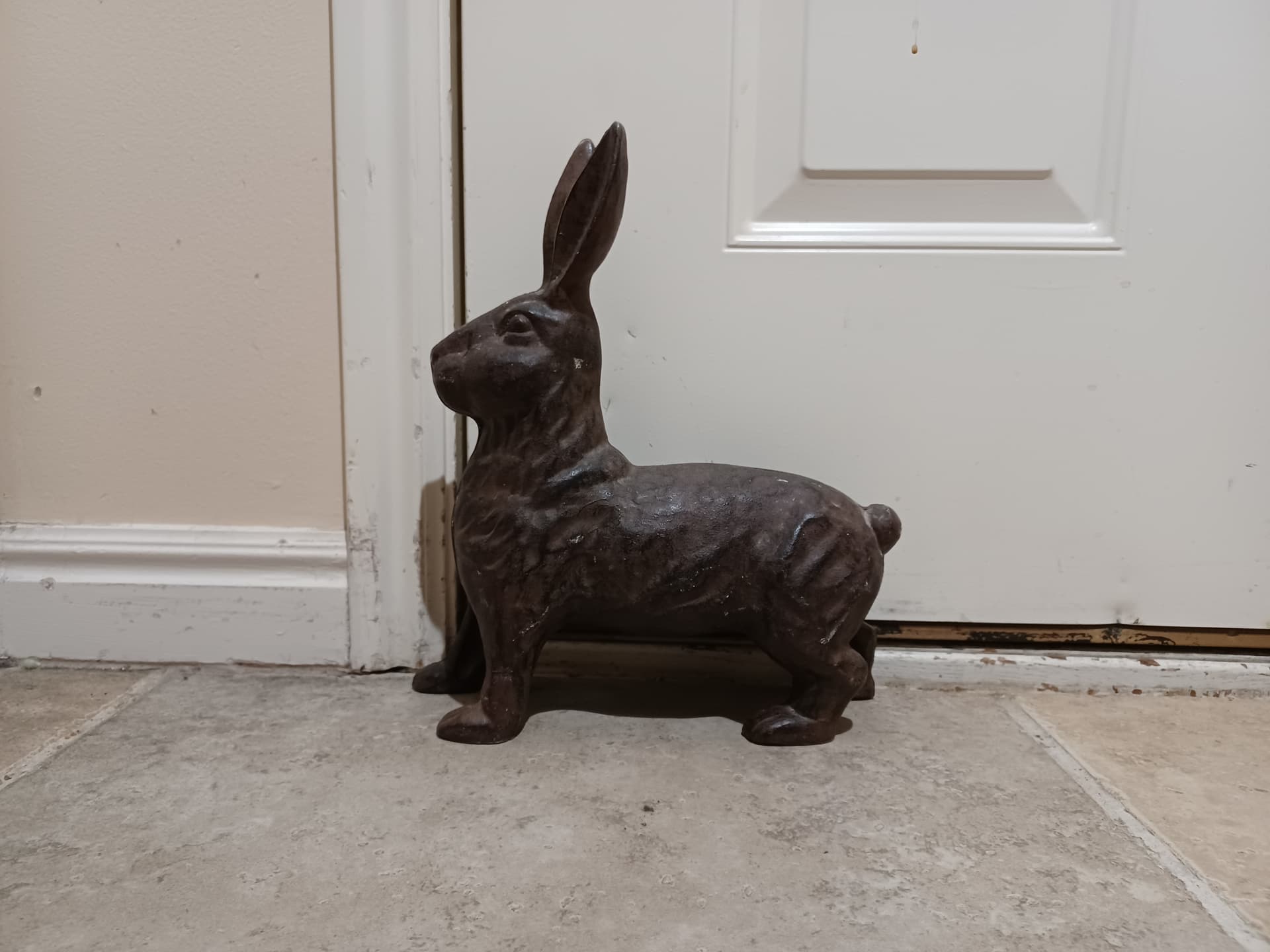

We use this guy, he’s made of cast pot metal and weighs around 8-10 pounds. When the door open and slides it along the floor it makes a lot of noise it’s also really top heavy so it tips over very easily making an even bigger sound. We can hear it through the whole place, giving us time to react to an unwanted entry also, hopefully, the sound would be a deterrent to the perp.

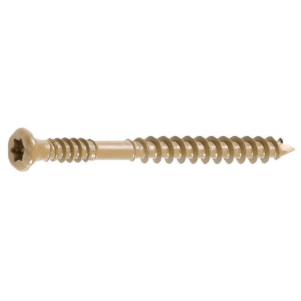

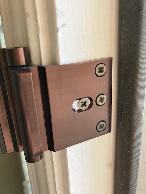

These are awesome, however they need to be adjusted properly and the foot needs to be cleaned often. In my previous home I used them. Newer home has 3 1/2 inch screws and deadbolts on every door. The doors are also less flimsy. Windows though are an entirely different story, I have glass break sensors on ALL of them.
Screws like this are really good for mounting door hinges and dead bolts.

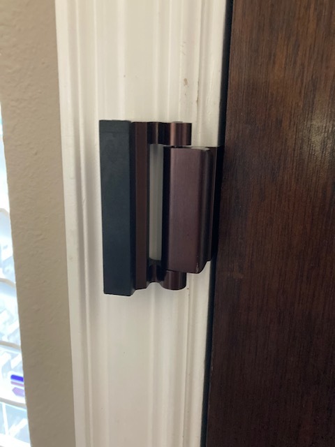

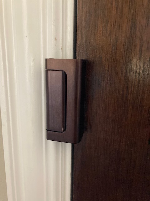

They look like great screws for striker plates and hinges. The issues with “door edge” security devices are:
  • door thickness limits how long your screw can be;
  • even “solid-core” doors may be filled with wood or fiber products having almost no pull-out resistance to threads;
  • the jamb-side part may not be far enough from the opening to reach building framing, and a pre-hung door jamb/frame will not be of very strong wood, either.
I think ordinary residential construction materials and methods will not be strong enough for “door edge” security devices to offer more than discouragement for lost drunks or a brief delay to a determined entry.
