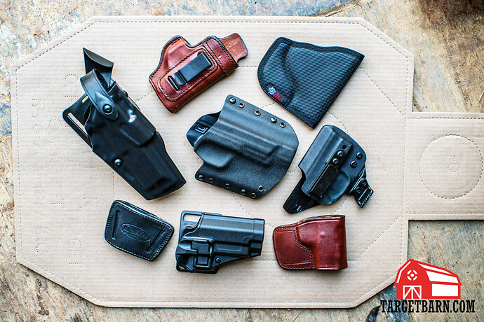

If you hold a level 1 holster upside down, should it hold the gun?
I am replying with a link-
Level 1 “Passive Retention”: Level 1 holsters have passive tension from an adjustable detent screw that provides tension on the trigger guard. No mechanisms need to be disengaged and only a regular draw stroke is required.
This is what I do. I check retention regularly. Last thing I want is my gun popping out during my day and then me try to quickly reholster and snag a shirt tail. Won’t be able to have anymore kids after that.
IMO, any holster being relied on to hold your gun for carry/EDC purposes should retain the gun when held upside down (including with the weight of a loaded mag), and even when shaken at least a little bit.
This rule is primarily for belt holsters though, it may not be applicable in the case of certain belly bands/smartcarry/pocket holsters, depending.
When I make a holster for someone, I ask them about retention. If they want it to stay in upside down while shaken, I make it tight and then wet-mold it. If they want it looser with a retention strap, I make that happen. My policy is “the customer is always right,” and I stand behind what I make 100%. I think that’s the right thing to do, especially for a “hobbiest” who is now in “small business mode,” preparing for retirement and full-time leather work!
I do make it a habit of testing my holster every once in a while. I use Kydex holsters and I want to make sure I get that secure click at all times. I believe that with time the retention can loosen itself and you may have to make the proper adjustment. I also do the upside down holster check as part of my test.
That’s a fine test (or marketing gimmick) for Kydex, and maybe “hard” leather when new. But an awful lot of hybrid and leather holsters will get their retention from the curve of the the holster on a belt around the waist. The “upside down” test, when the holster is not on a proper belt strapped to a proper person, has little or no relevance. IMHO.
