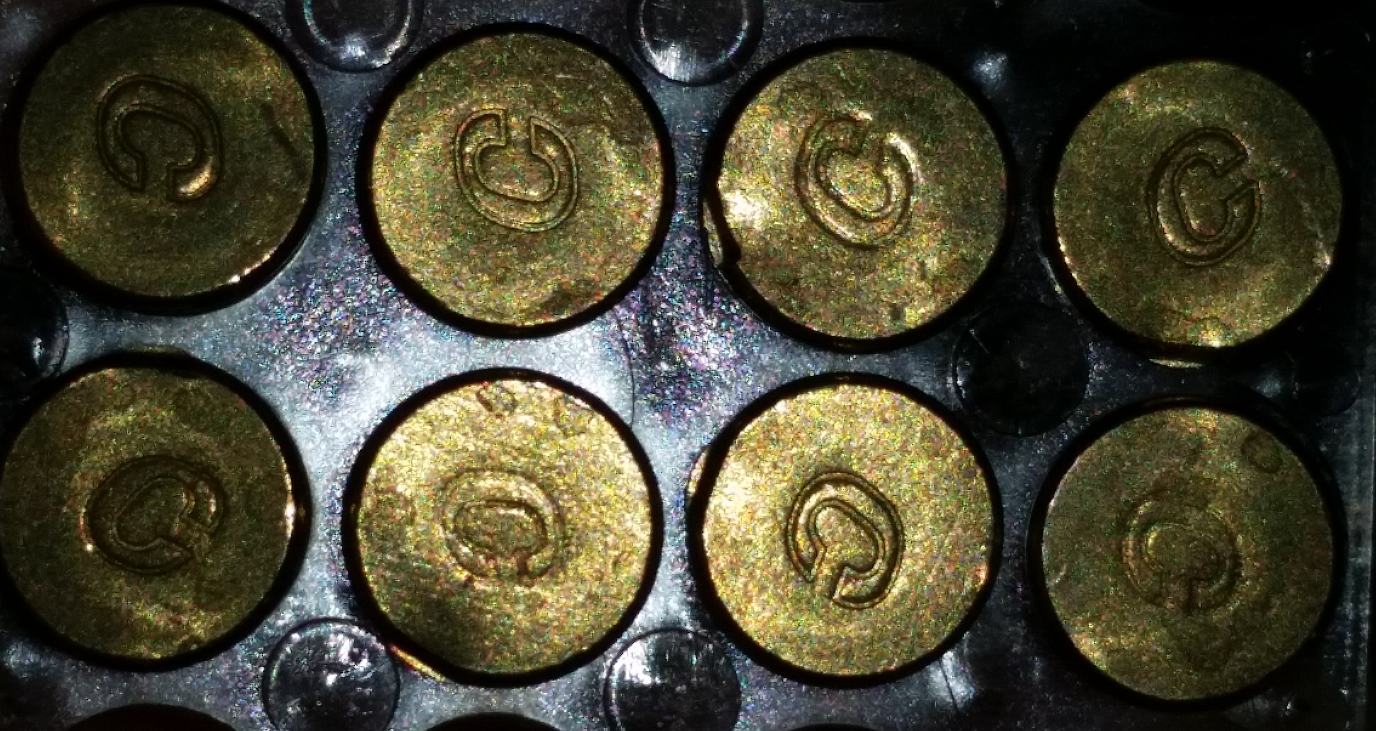

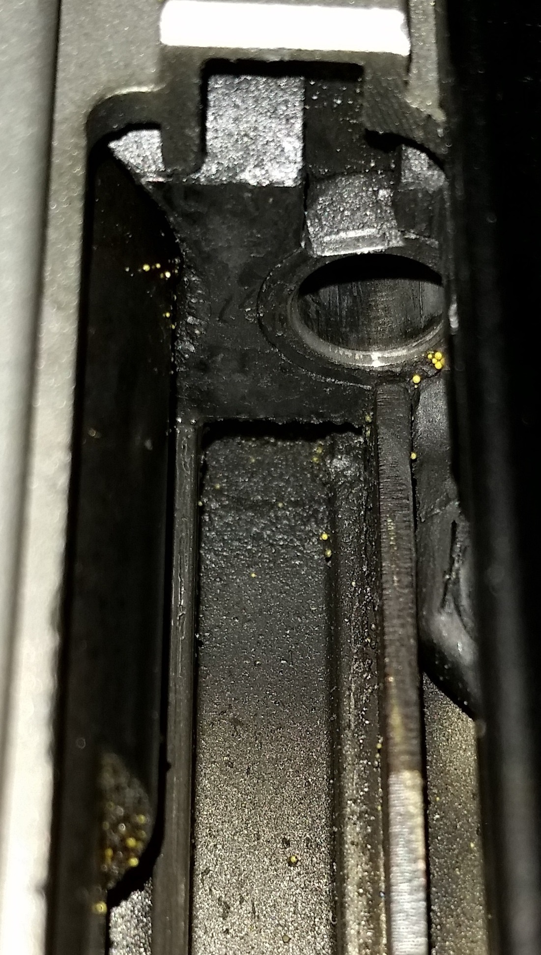

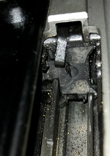

Hey all. I picked up a Kel-Tec CMR-30 about a year ago and it has been an up and down journey. When it works, it is superb. But it has barely run a full mag in nearly 700 rounds since new purchase. The initial problems were down to old style magazine springs which they swapped for new mags with firmer updated springs. I shot it yesterday and it ran through one mag of 28 cartridges perfectly, but the second mag shot a bit then the trigger just went click. I continued to unload and try again, but each time just click, remove cartridge with knife, cycle slide, then click again. I’ve written to them and hope to hear back later this week. A few pics:
Looks like your firing pin is broken off and/or rotated 90* out of turn. Do you have a successfully fired case to show that the FP strike looks like?

I thought something similar. I was not smart enough to save a good one. Can a simpleton reorient it?
I’m not familiar with that platform at all but if you know how to get the bolt out it should be pretty obvious if it rolled. From your pic it looks broken off or stuck in a neutral position. Try cleaning the bolt. Mebby hit it with brake cleaner and see if it moves back?

Thanks again guys. Learned a lot. Got the firing pin (and a spare) last week. Put the new one in this morning. The old one was broken at the base. Took the opportunity o clean it while it was apart. Let’s hope that this is the end of the saga. It is worth noting that the Kel-Tec guys were helpful and sent the parts n/c instead of me sending the firearm to them. Easy and cheap for everyone.
