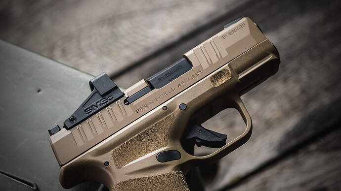

I considered trying the Hex Wasp or Shield SMSC for one of my Hellcats because of Springfield’s endorsement.
And I looked at several reviewers:

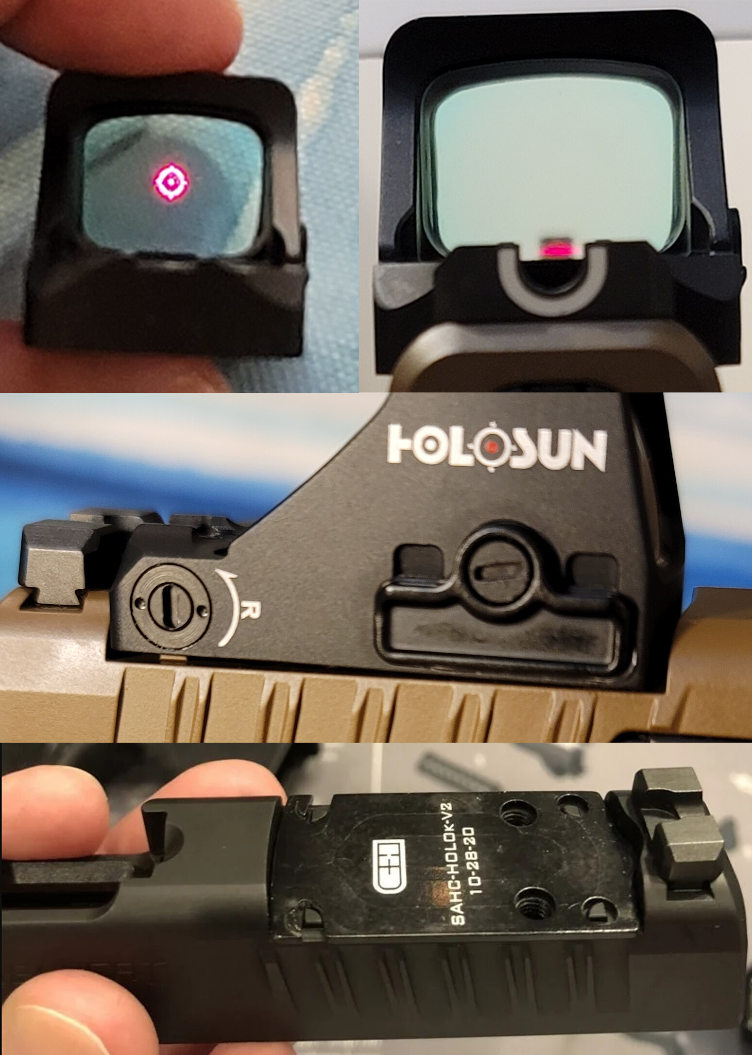

But yesterday I bought the Halosun HS507K-X2 because
  1. Red ring to find dot faster
  2. Battery access to eliminate unmounting and re-zeroing
  3. Co-witness cuts in case accidental damage, electronic failure, or if the battery runs out before or during use
  4. Always on (Shake awake)
  5. Water proof/resistant in case of rain or accidents
I’m shocked no other micros (> 1.7"x1") have a red ring and most place the battery underneath.
Only the non-micros have room to place the battery on top but Halosun even offers solar a battery backup on some.
The only drawback is ordering the $45 mounting plate (https://chpws.com/product/springfield-hellcat-to-holosun-407k-507k-adapter-plate) which may remove co-witnessing or require suppressor sights, or milling/grinding off the lugs:
Professional: HELLCAT HOLOSUN 507K Slide Modification. - YouTube
Do It Yourself: Springfield Hellcat OSP: Removing the Slide Lugs and Mounting the Holosun 507K - YouTube
But for now I’m waiting for my plate to arrive similar to the uploaded picture.
Until other companies offer micros with features 1 & 2, I may have to stick with Halosun.
