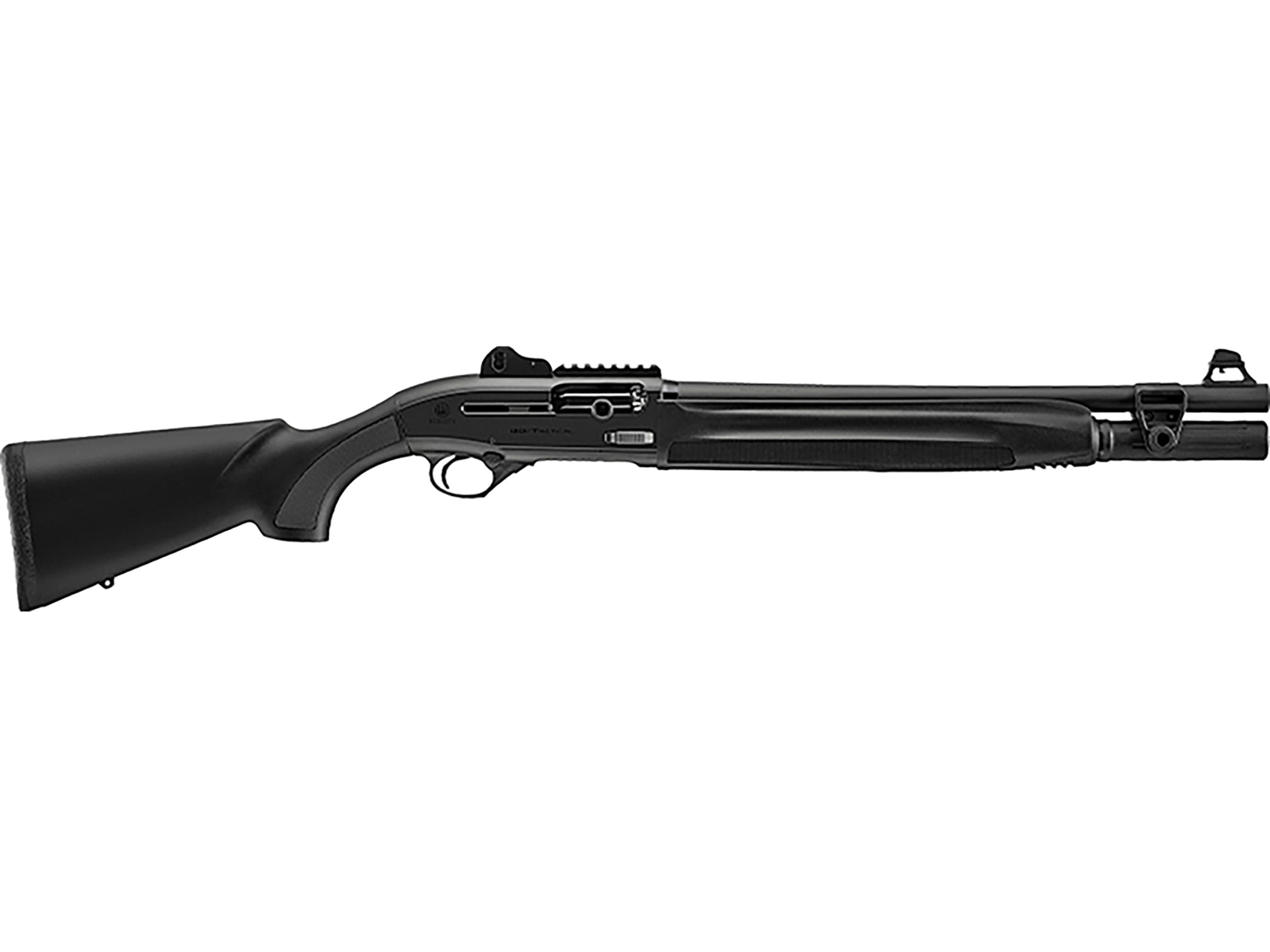

If you want a “here get this” shotgun option…get one of these
Sticker shock? Good news, a solid AR type rifle can cost even less.
(so can a solid shotgun, but if you want to buy once cry once, it’s Beretta or Benelli)

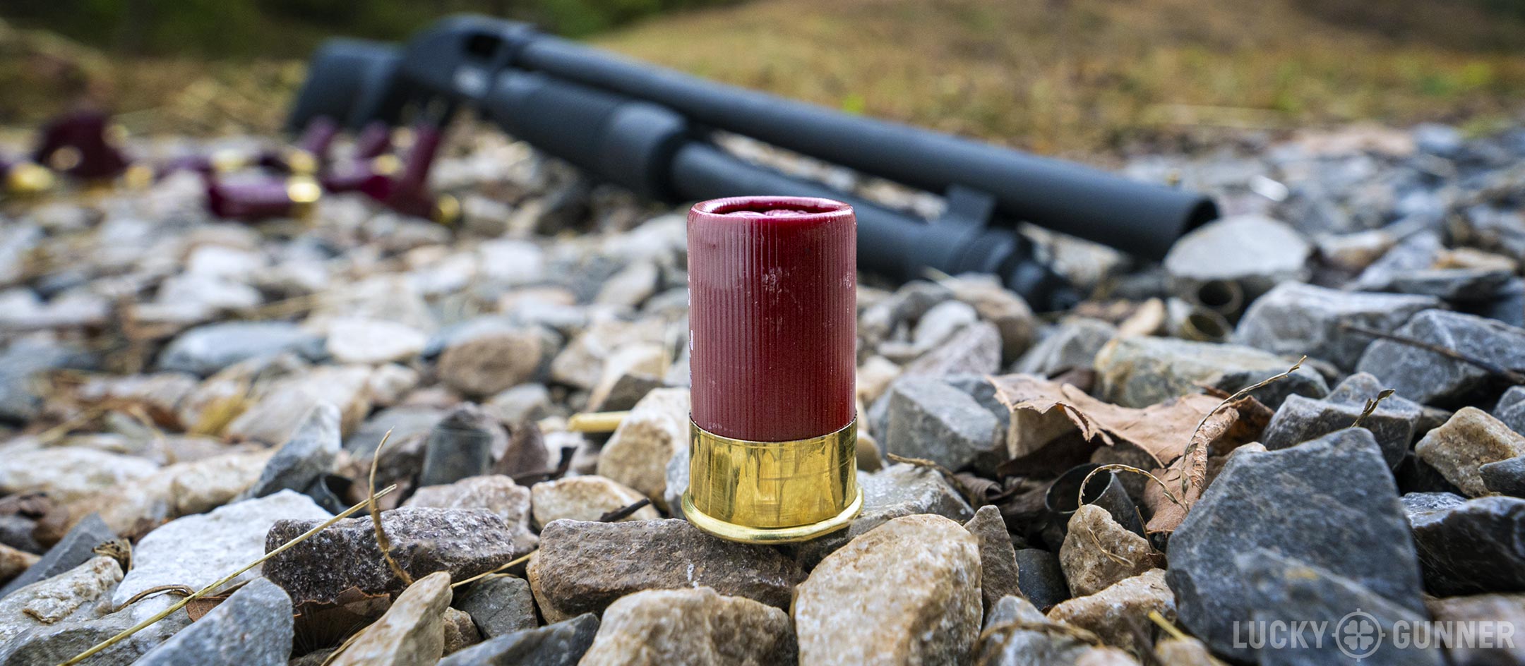

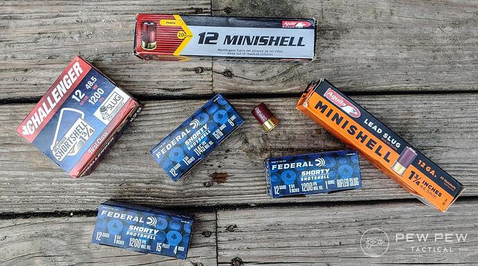

Mini shotshell ready out of the box for less kick and over-penetration.
You know if that’s bird or buck shot. Appreciate any specs or link to that ammo — I can read up on it. It’s new to me. ![]()
Neat. I don’t think I’ve ever heard of those mini’s. Reading about it now.
Make note that Lucky Gunner, correctly, says:
The other #4 pellets settled between 8.5 and 11.5 inches. That’s not too surprising for #4 buck – it’s often considered right on the edge of being acceptable for self-defense
Like I said before, #4 is kinda iffy. Depending on who you ask, it’s either unacceptable for self-defense or barely acceptable. And that’s when it’s in a full size load with 30 or more pellets.
Now, for the mini shells
the current options all have borderline terminal performance and shot patterns that leave a lot to be desired.
Since we know that conflicts with shotguns rarely involve more than one or two shells fired, why would I want to give up some of that effectiveness for more ammo capacity?
The reduced recoil is nice. The mini shells are definitely a lot of fun to shoot. They could be a useful teaching tool for a shotgun novice. But recoil aside, pump action shotguns are still difficult to master. They lead to more user-induced malfunctions than any other modern firearm. For someone who is recoil sensitive, something like a pistol caliber carbine would be much easier to learn and use under stress.
So overall, I think the mini shotgun shells are not quite ripe for serious use yet. The slugs have potential if you just really want that extra capacity and you’re not after the super light recoil
