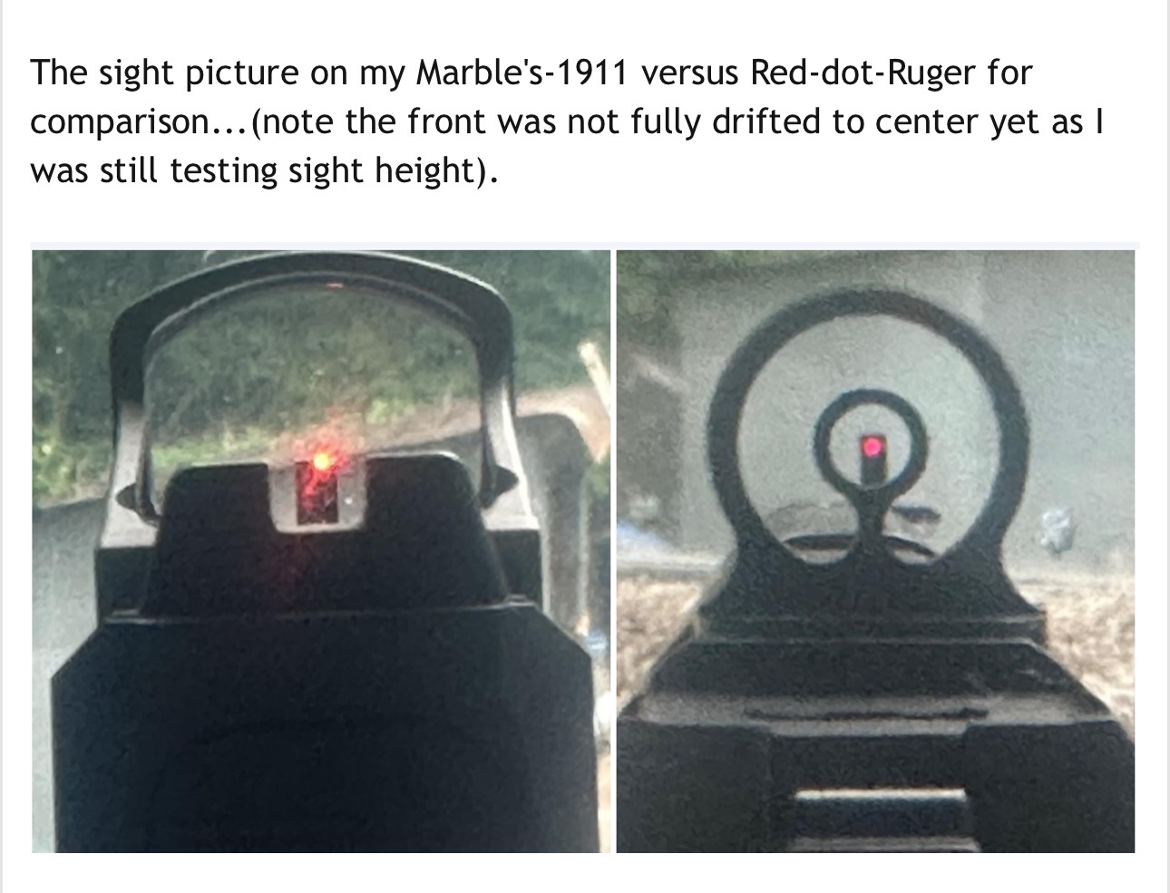

I will try see if I can add photographs or even maybe a 5 second video that shows the advantage of the sight system but basically you need to try it to see how good it is. Find a firearm that has a rear dovetail similar to the Marbles Bullseye (my 9mm 1911 was the same size), and try it. And then if your preferred concealed carry gun does have a different dovetail size, You will probably find it worthwhile to get a couple files and a vice and contour the site to fit your particular firearm. In my case I also had to make the front sight out of a regular suppressor height sight, which I filed down to the proper height and drilled with a Dremel tool for a fiberoptic (same stuff you use in a bow sight).
I could only upload the one ‘allowed’ image, but this at least captures the less-bulk, (you don’t need ‘backup irons’ since this IS an iron, plus the frame/shell is so much lighter). The side view shows the sight to be maybe twice the height of an ordinary ‘iron’ sight but super light weight. What another picture could show is that you see the ‘red dot’ on the Marbles/fiberoptic system long before the sight is ‘fully aligned’, enabling far faster target engagement. It also works better in dim light or with a weapon light at night.

Don’t know how much help this would be for folks with astigmatism. Front and rear sights are same distance apart as regular sights. The (Green, in my case) dot really helps people like me because of a single focal point.
Ghost ring rear sights have been available for a long time. The one below is for a Glock.
