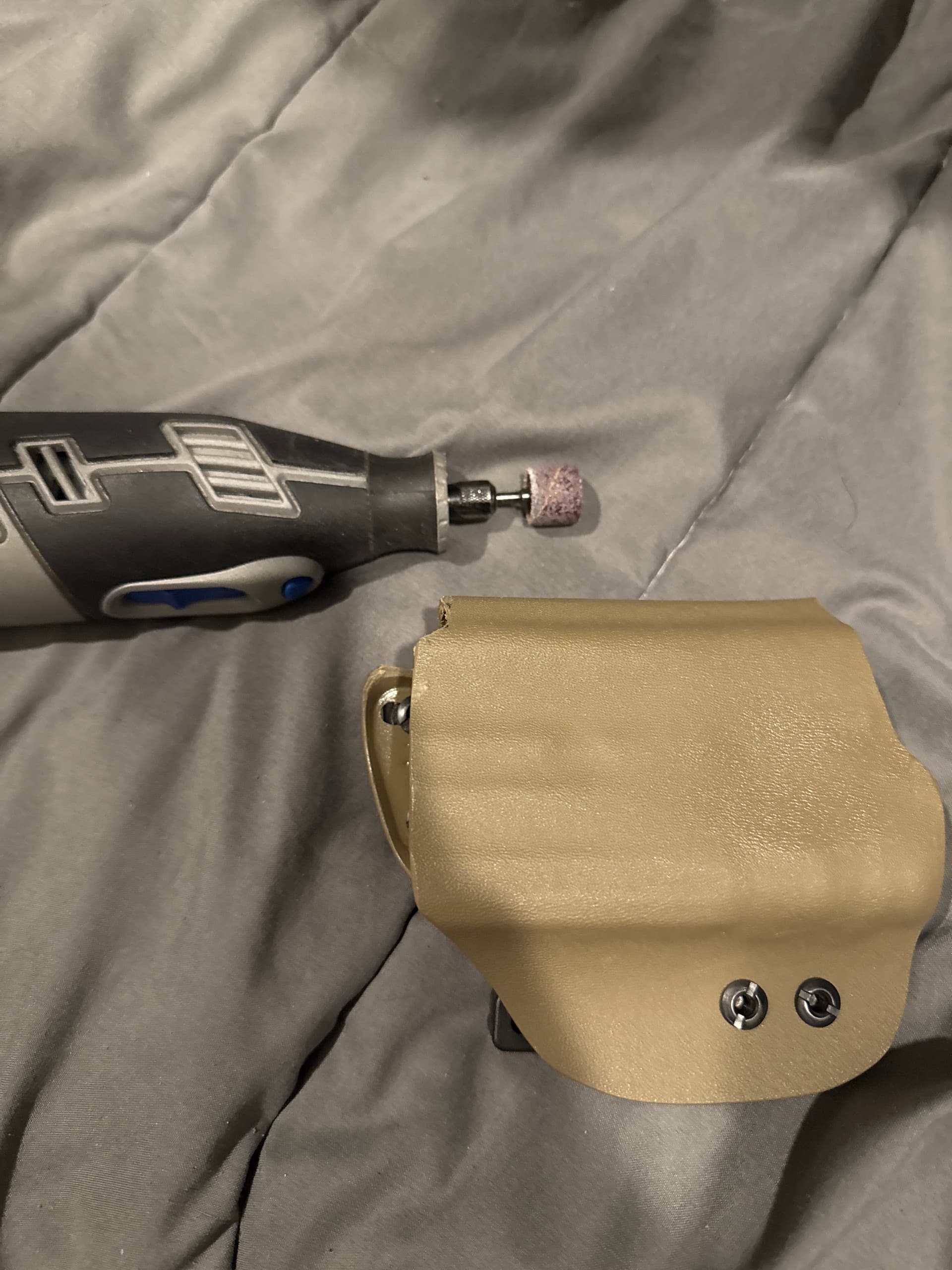

I mark the holster with a sharpie then use a dremel with a sanding wheel.
Cool, so you don’t cut, you just sand it down?
Yarp. (Hot Fuzz for ‘Yes’) :grinning_face:
A Dremel will make quick work of it.
+1 on dremel. Safest way without removing too much.

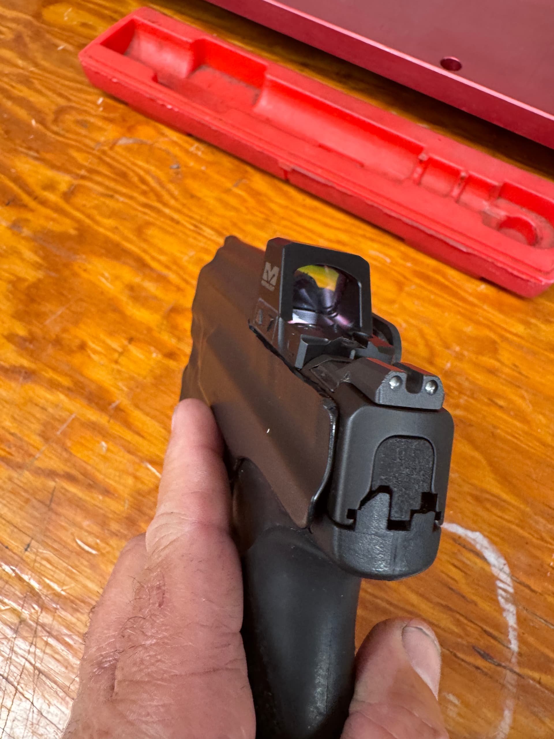

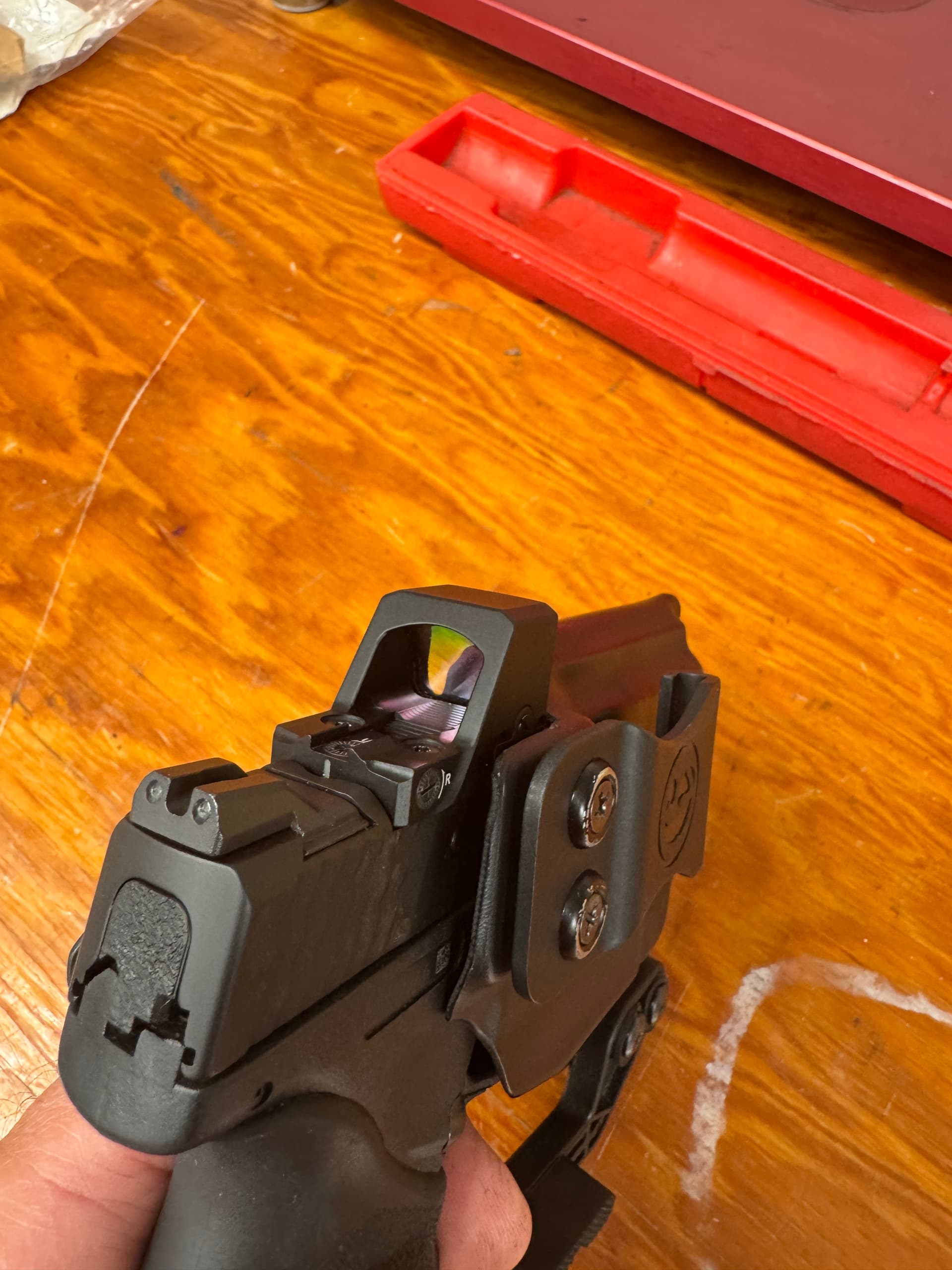

I just modified my holster for a red dot…I used shears to do the rough cutting in and a sharp razor to trim and fit for clearance.
Don’t rush and take your time!
