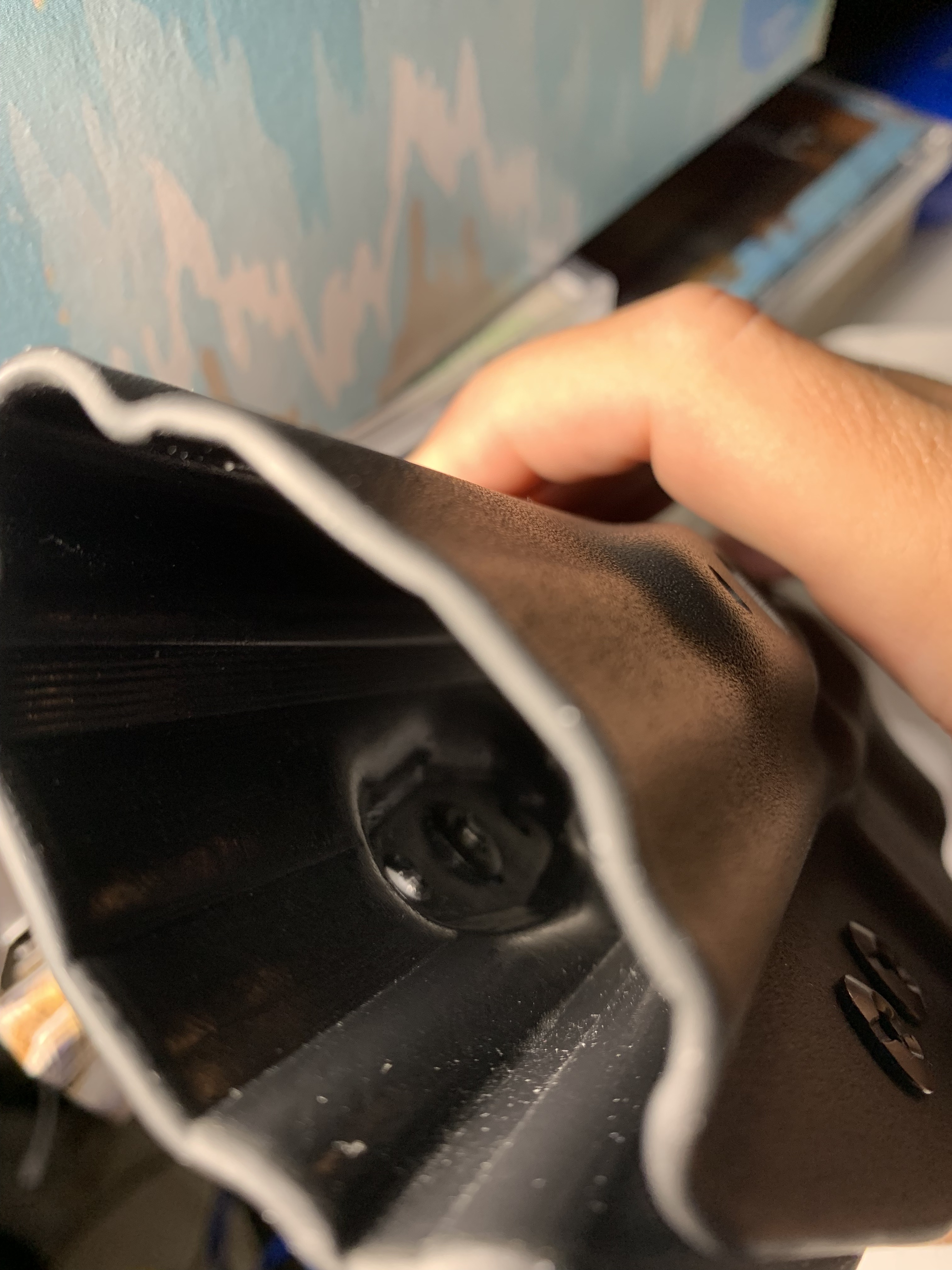

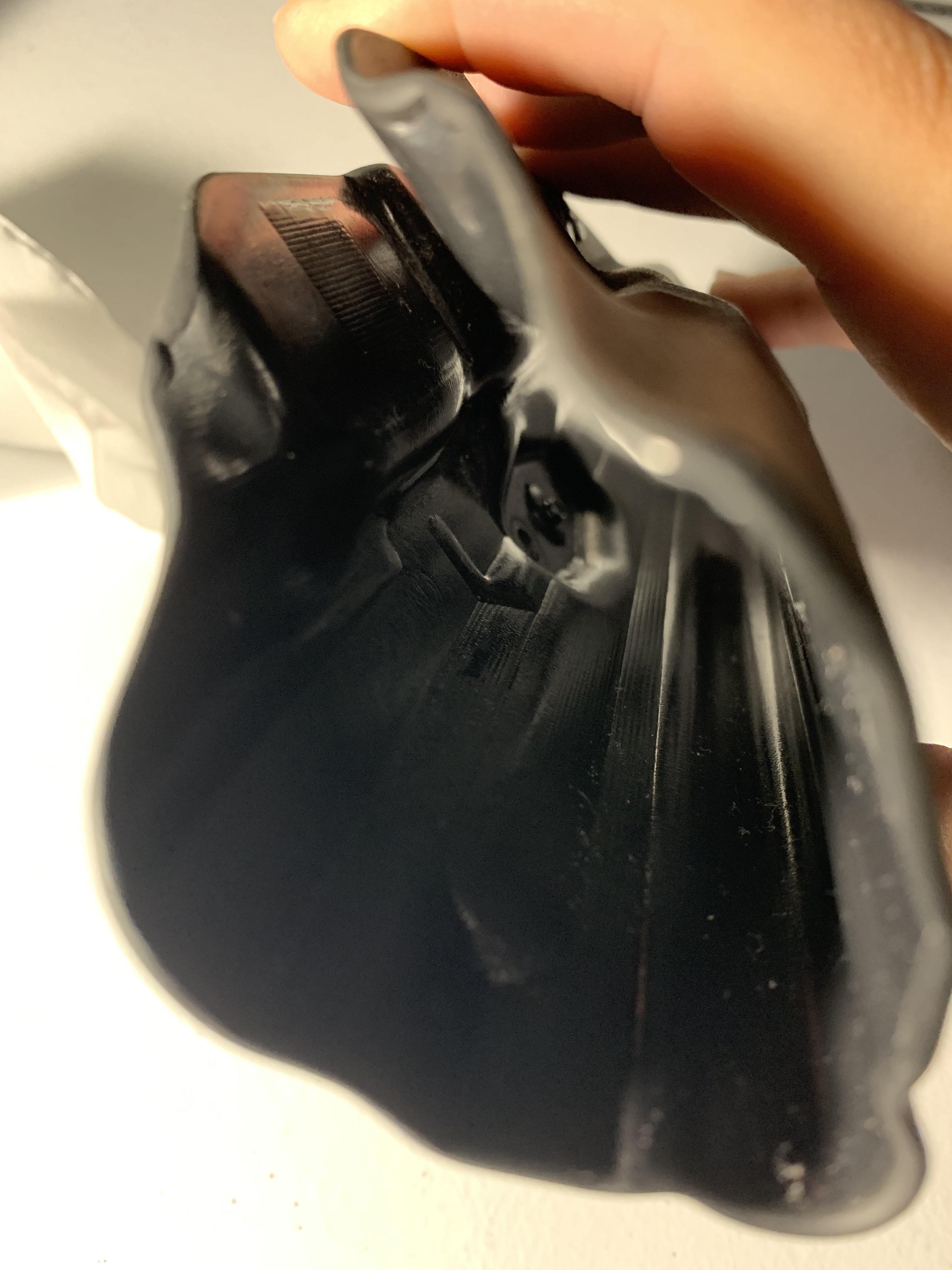

When I changed the clip out to the UltiClip 3, I accidentally over tightened one of the screws. Now, when I try to loosen it, I feel the post turn with the screw. I’d tried using something similar to LockTite, but what I had didn’t set up, even after more than 24 hours. Dorian’s at least going to be coming close to us, so the stores are either out of a lot of stuff, or closed. I’ve tried getting Needlenose pliers on the bit of the post inside the holster, but I can’t keep them on it due to how little there is to grab. I need to be able to get the screw out, since I received my new gun belt from Tactica Defense Fashion, and I want to be able to “test” the belt for myself. Any ideas on what I can use that is most likely somewhere in the house to hold the post in place so I can get the screw out? I’ve thought of trying some superglue or liquid nails (in case mom doesn’t have any super glue), but I’m wary even though it is the screw that’s in the middle hole out of 3. Any thoughts? To limit any confusion, I uploaded pictures of the offender.

I have belly bands that I’ve mainly been using, but since I received the gun belt I’d ordered, I want to change the clip out for the O clip so I can use it with my new belt. I’m not sure what you meant when you mentioned the eustachion. I attached pictures to my post so it’ll be more obvious what I’m working with, and which screw is affected.

@HeatherLP The eustachion is the metal bit that the screw screws into, you called it a “post”. You may be able to get at it by removing the 2 tension screws and prying the holster wider with say the handle of a hair brush or similar. This may buy you the space you need to get your needle nose onto it.

I took a good look at your pics, and it looks like the e-whatdoyoucallit-I call them rivet-nuts-has broken away from the backing plate and is rotating with the screw as you try to remove it. I would drill off the screw head take the clip off and try removing the rest with pliers. Kydex is not very strong, so I think this attach point is probably unusable. If you can make do with the other 2 attach points, you should be ok, but IMHO, this one is a goner.
I can get the needle-nosed pliers on it, but they slip off quick. It’s a trick to get a hold of it to start with, since it’s thin. I’d need at least 3 hands, 1 to hold the holster at just the right angle, 1 to hold the pliers, and 1 for the screwdriver. The hand holding the pliers would need to almost constantly re-grab the eustachion, judging from what kept happening when I was trying to do it by myself.
