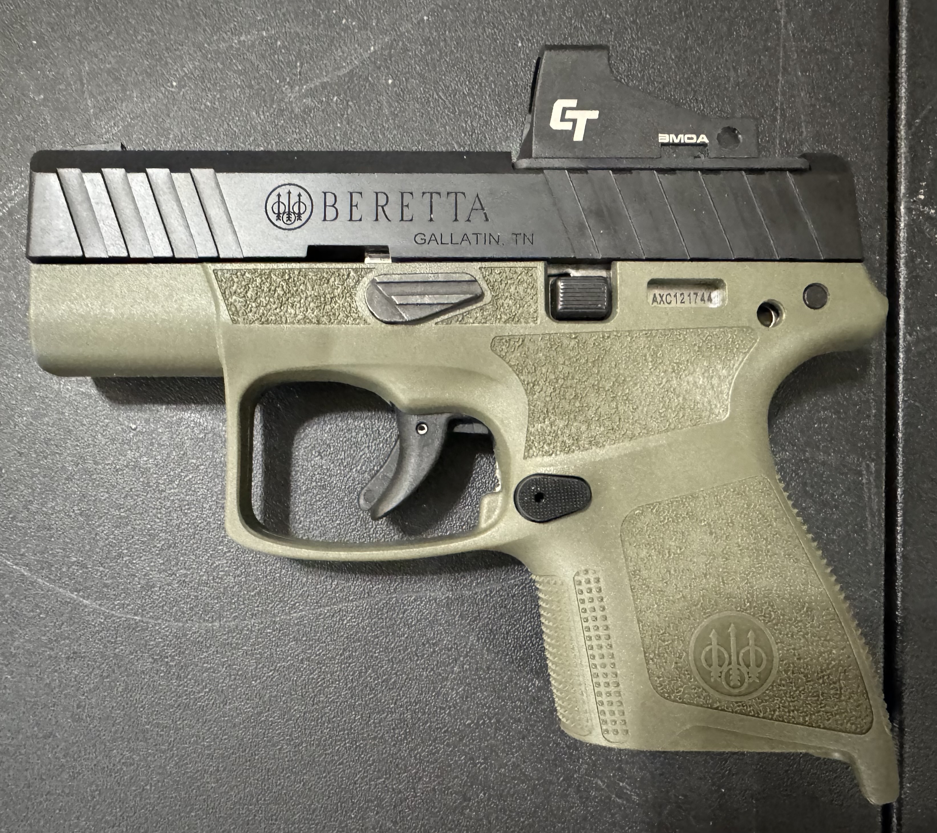

Recently picked up the Beretta APX A1 Carry.
I like it. It’s a solid firearm by one of the oldest brands. So I’m running this through with practice ammo. Running into a stovepipe problem at the range from time to time. At first I believe the stovepiping was due to the factory oil sort of gun king things up. After a thorough cleaning of the weapon, I took it back over to the range and while I had around 8 out of a hundred or so rounds the first time, I still had a few.
A different time I was unexpectedly at the range and bought some Federal ammo in 9mm Luger and did not have one.
So it was the ammo. It was herters, not to disparage the brand. Just saying. The federal worked no problem.
Anyway, this is my every day carry pistol so I really don’t want it to misfire under duress. That would suck.
If it was a new gun or new recoil spring sometimes the spring has to get worked in. Sometimes a firmer grip will stop the stove pipes.
I’m not familiar at all with the Beretta pistols or Herters ammo. Not sure if that pistol has a break in period or not? Maybe the other ammo was the problem or maybe you shot it enough to smooth things out and now your good to go?
I like to have 100 to 200 rounds of good quality practice ammo without a hiccup followed by 100 rounds of whatever self defense ammo I am going to carry before I completely trust a new pistol. More if the pistol is newer and doesn’t have a solid reputation for reliability yet.
Been fighting with the grip a little because it is kind of small. Adjusting though. It seems to run this other ammo pretty good so far.
