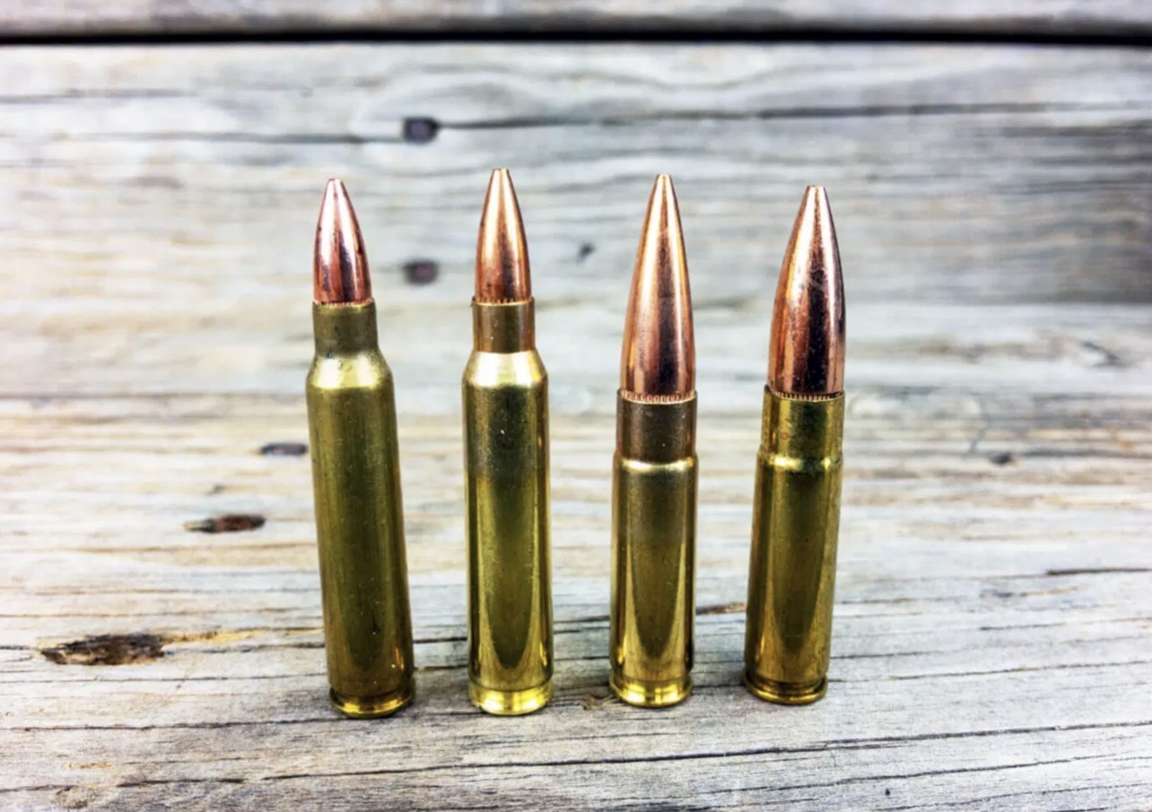

Soo, to my understanding .300BLK was designed to match the older and more ballistically efficient 7.62x39 (AK-47/SKS round)
The standard m193 55grain 5.56x45 round is flatter shooting and faster to target, however is somewhat less effective against barriers and body armor than the 7.62x39
So to compensate for that the .300blk was designed based off of the nato 5.56 round and weapons platforms.
It’s for all intent and purpose, a 5.56 case that’s cut down and necked to .30 caliber with a far heavier bullet loaded in and a slightly different powder charge.
As to the difference in recoil,… I don’t personally own a .300blk rifle, though I have shot a couple… it basically felt the same as the 5.56. Or any AK/SKS 7.62x39 platform I’ve shot.

This is the danger of .300blk!
It is the same casing and over all length as a standard 5.56 round!
It uses the exact same magazine, and will feed into the chamber of a 5.56 gun….
However, a .30 caliber bullet won’t go down a .22 caliber barrel… and you get a violent explosion!
