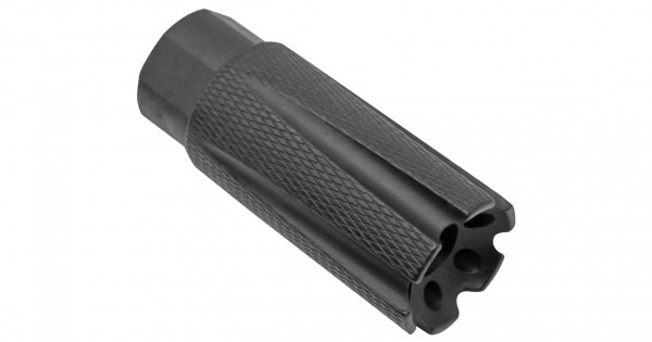

I have linear comps on my 9mm ARs, flash/gas propels and directs the sound forward toward a target.
These are friendlier to shooters on to your sides as well to other shooters on the range line as the sound is directed away and not the the sides as other comps.

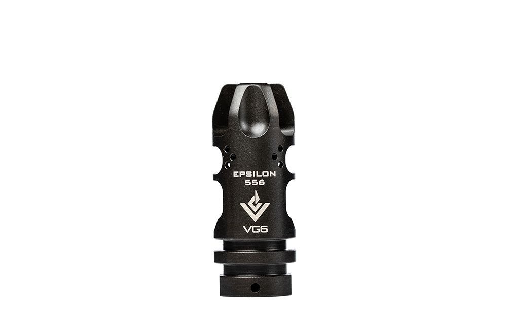

@Gary_H I put the Epsilon VG6 on my AK-47 and I really like it, even people who didnât know it was on there commented on how controllable it was.

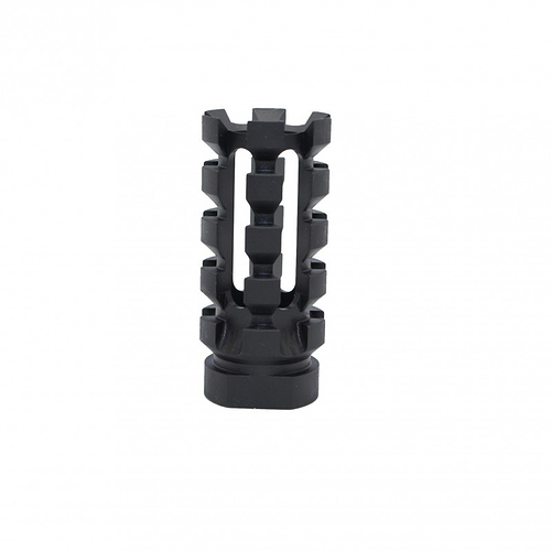

Alright, I am torn between two different constructions. I am really attracted to the Krinkov - the only drawback I see is weight - 8.4 oz. of torque hanging off the end of a 10.5" barrel âsoundsâ like a lot.
The other design is less than half the weight at 3.4 oz. I found one video that compared this design to an open barrel with about 3 dB noise reduction at the shooterâs ear. Thatâs half as loud, so attractive, but I suspect the Krinkov does better.
Any thoughts?
edit: after I posted this I got to thinking more about my own questions. 8.4 oz @ 10.5" is less than 1/2 ft-lb of torque on the base of the barrel. If it canât take that, then there is something wrong with it. The Krinkov has a lot more volume than the 6 port and disassembles for cleaning. Depending on shipping the Krinkov should be here ⊠maybe soon?

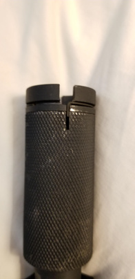

I got the Krinkov installed. I reused the crush washer, figure it wonât hurt?
Since I have never seen one before, I have a question. The spring clip lines up about a 1/16th of a turn before the cone gets screwed all the way down on the housing. Therefore there is play back and forth between the two parts, but the spring keeps it from backing out. It this normal?

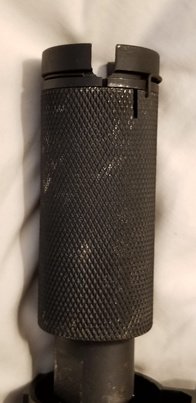

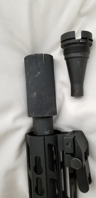

@Henry4, this is a 3 piece Krinkov; the housing, the screw-in cone, and the spring clip as shown:
The cone will screw on past the alignment slots for the spring clip:
And to complete the picture this is how it looks with the cone backed off a bit and spring clip in place:
The crush washer is between the barrel and the housing. I donât believe barrel indexing matters with this style of flash can.
@Gary_H Excellent pics and wording. You have just demonstrated how the Krinkov is almost âidiotâ proof in that if you back it off from the spring location 1 turn it almost comes apart and by over tightening the spring tells you that you are wrong. The separation between the cone and the can provides and âexpansion chamberâ for the gasses to escape into and get cooled /slowed with the increased volume while not being forced out the front. Which is of course how it works.
