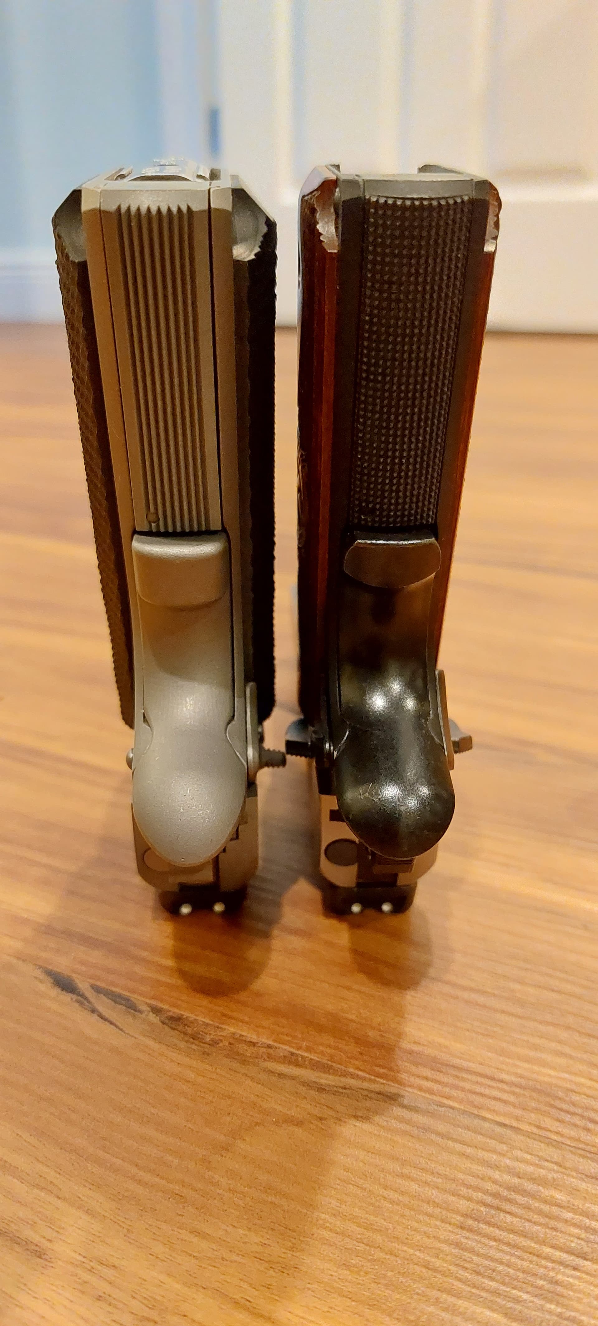

Does anyone know for certain which MSH would fit my Springfield EMP4? Short of taking the MSH out of a Government size 1911 and trying it in the EMP4, which I can do, it is just very time consuming, I have not been able to figure it out on my own. BTW, I am not optimistic regarding help from WC at this point.
This photo shows a Colt Government Model on the left and the EMP4 on the right. Springfield calls the EMP4 a compact. The 2 MSH shown appear to look the same. The measurements I can take with them installed appear to match as well. I admit I don’t know how subtle or gross the differences between full-size and compact are.

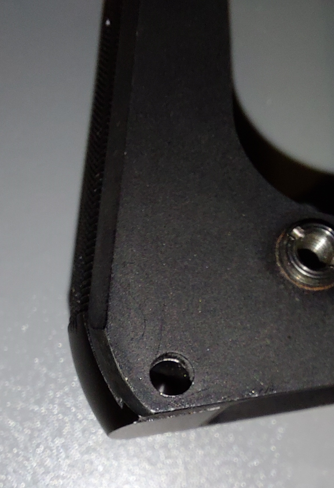

The WC round butt MSH looks like this:
VS.:

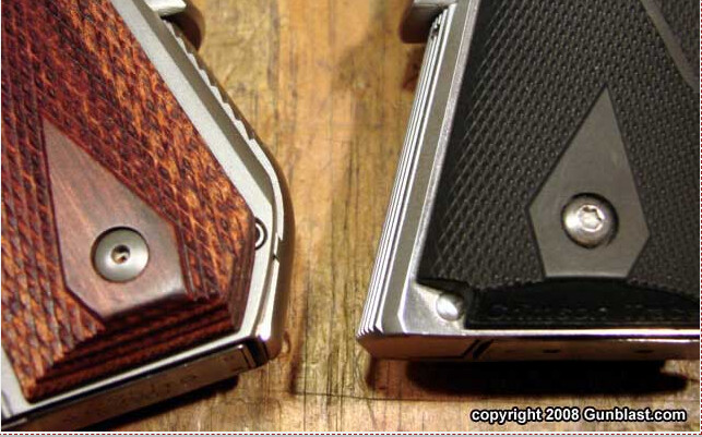

For completeness, this is an Ed Brown Bobtail:
So you are not gonna use a short MSH. Yours will have just rounded shape outside, meaning, the internal parts remain the same?
Yes to all that. The internal parts remain the same with the Wilson Combat option. The WC round butt is almost a drop-in modification, other than some filing/sanding/polishing blending of the corner of the frame. I would venture to say very few people would notice if you put the original MSH back in.
The Ed Brown bobtail is a no going back option. The hole(s) for the original MSH are completely filed/blended away.

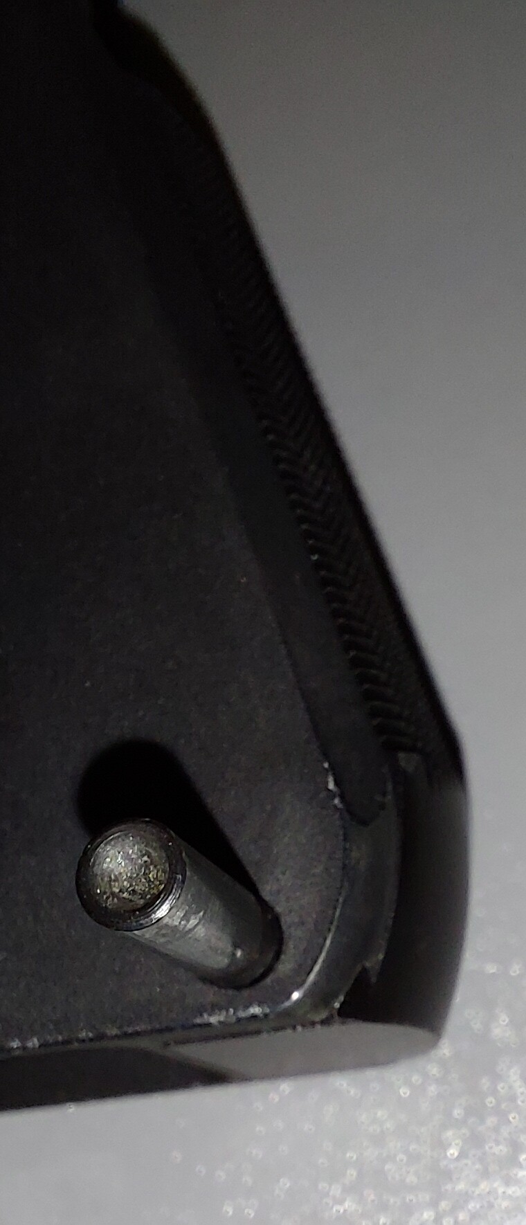

With Wilson Combat 20% off most stuff on their website, I ordered the round butt MSH. It looks markedly different than the one I pulled off the internet and posted above:

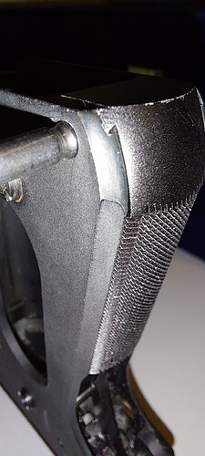

Of course I couldn’t wait to put it in, but don’t know when I will be able to get to the “gunsmith” filing, fitting, and re-finishing part:
Since I bought the AL MSH, it will be easy to reshape it more like the “internet” photo if I decide I want to.
Shouldn’t be a big deal to remove the material from the grip to match the MSH shape.
Be sure to leave enough material around the pin to avoid crack.

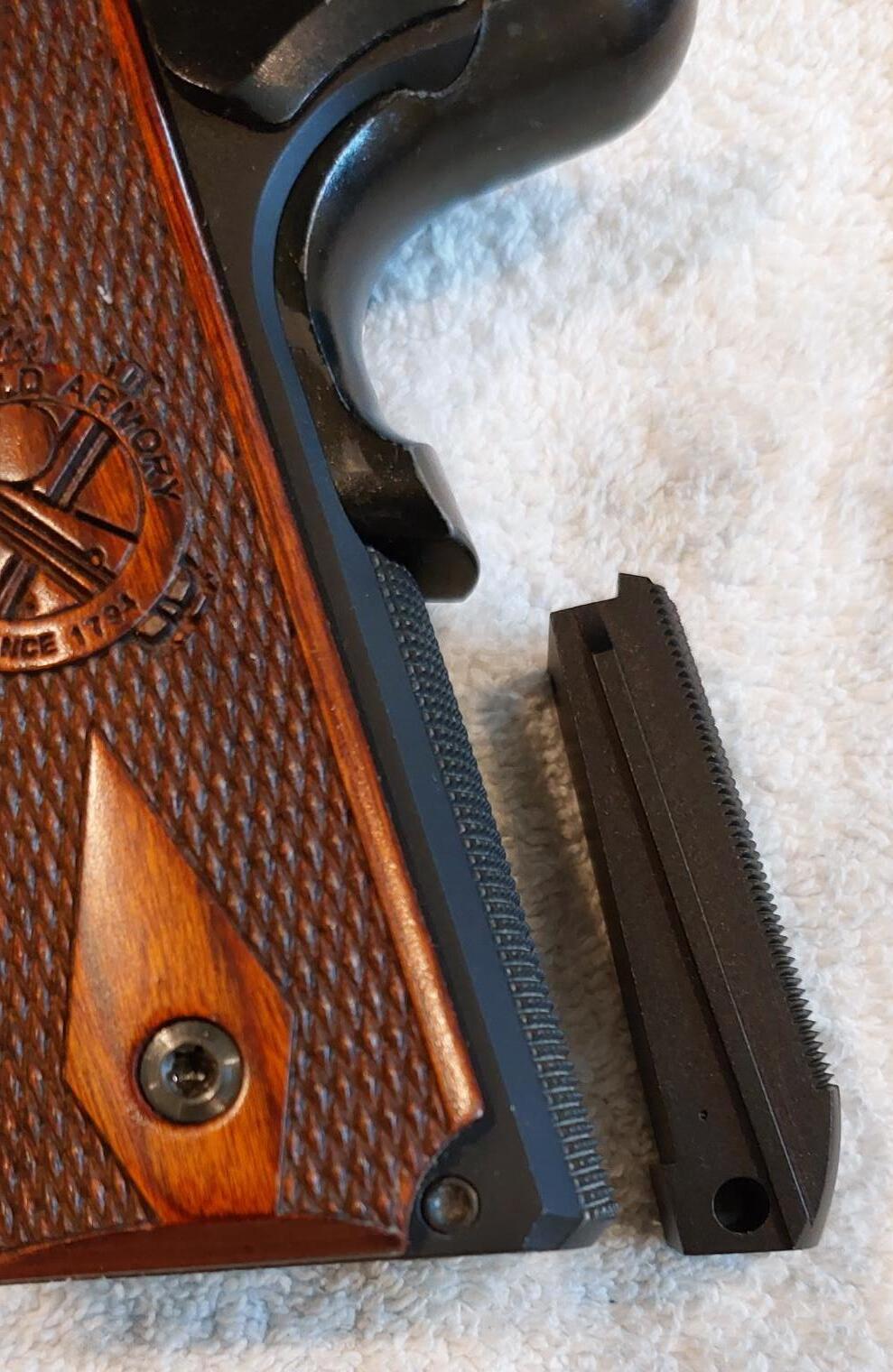

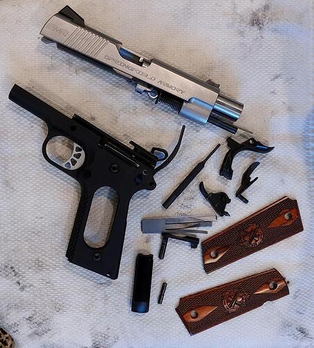

So, I got some time to revisit this project today. Of course it started with some disassembly:

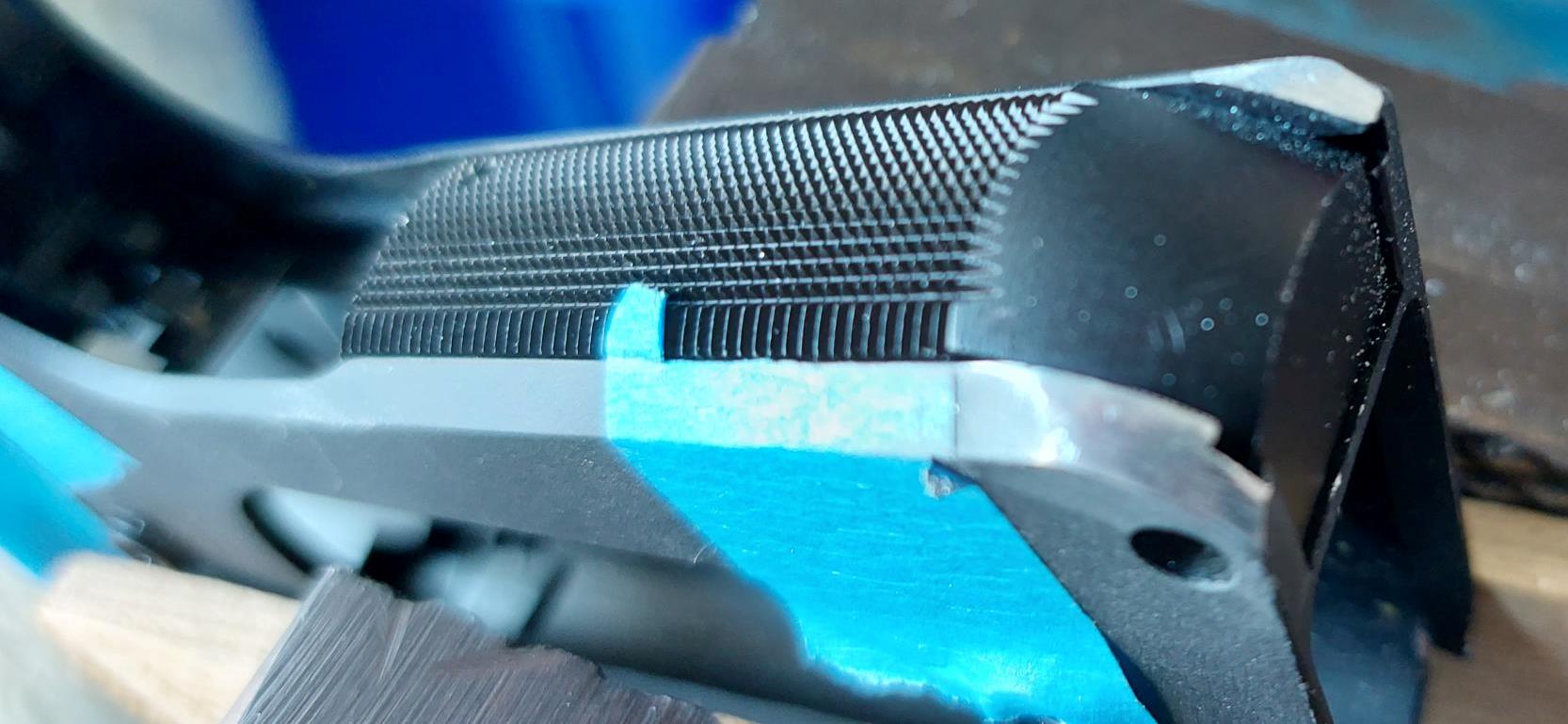

And masking off rough amounts of material to file off:
Filing, polishing down to 2000 grit sandpaper, and looking at it began:

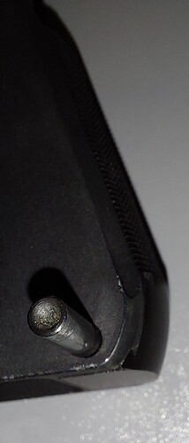

Then put some Birchwood Casey Black Aluminum on it to see how it looked:
I will clean up all the aluminum filing particles tomorrow (or soon), re-evaluate what needs additional polishing and finishing before reassembling.
