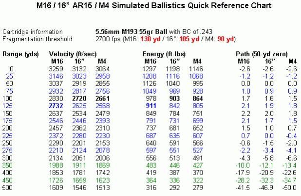

Don’t know if this is any value to you.
50 yard seems to be what I would gain the most advantage with.
