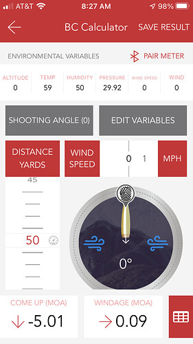

Hornady has a nice app for this. They have some preloaded Hornady information. It also has a section to manually enter the info.
I’m hoping to hit the range tomorrow to shoot a new rifle. This is the ballistic info for the bullet, and rate of twist for said rifle. I’ll let you know if this is accurate.

Here you go. I plugged the numbers in for a Hornady 55 grain hollow point 5.56 NATO round, with a 50 yard zero, and a 17 yard(51 feet) zero.
Forgot to add the last screen. This is the drop for the 5.56 zeroed at 17 yards.

I love the Hornaday app. So useful and super easy to use. I do use Hornaday a lot which makes it even easier.
