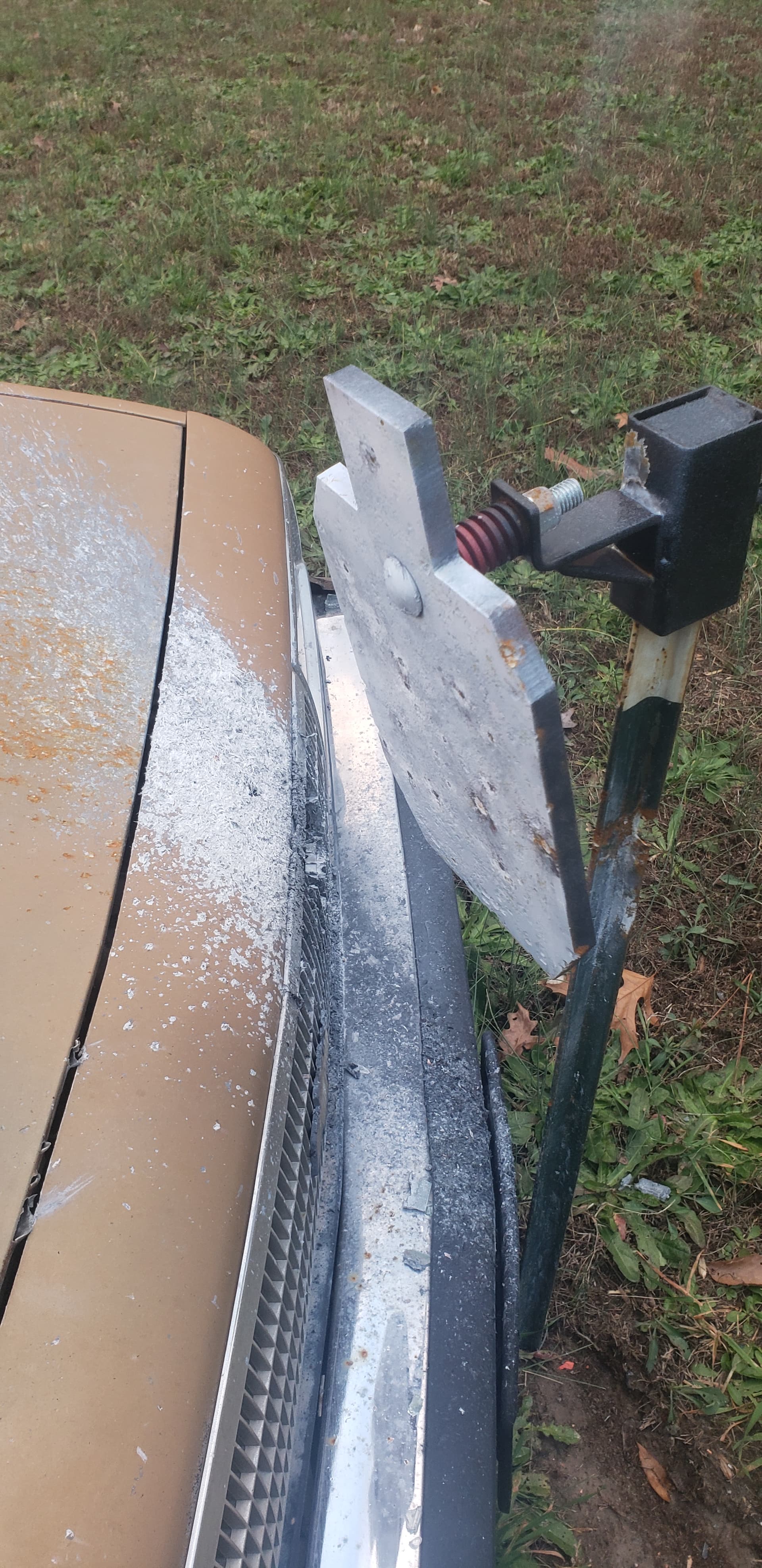

Spall is serious business. Always angle your targets downwards so that it throws the spall to the ground. Not back at you or up in the air. Check your mounts often. Spring loaded targets work the best, they dont loosen up and move anywhere near as bad. You can see the spall stripe on this target setup across the bumper of the car. copper jacket will come off with enough force to still cut/puncture tires inside of 2 or 3 yards. Anything inside of 25 feet or so should be on paper only.

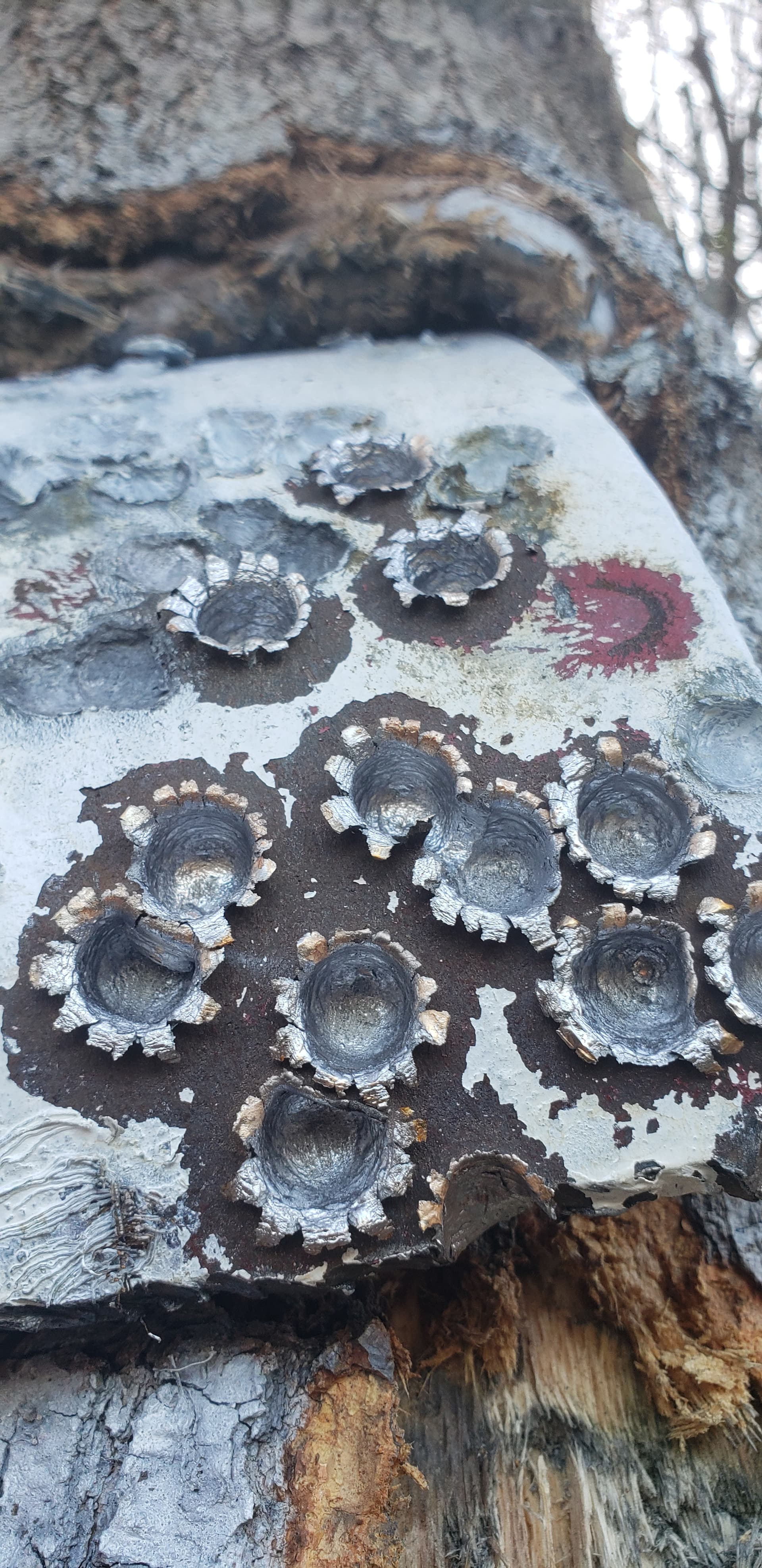

took me a minute to remember where this picture was saved lol. little razor sharp inverted mushrooms of death. Thats why you don’t shoot mild steel with high powered rifles up close. Those shots were still from a 18" 556 AR at 100 yards… when it craters out, it shoots lead straight back out of the holes directly back at the shooter. this was just regular old 55g FMJ
