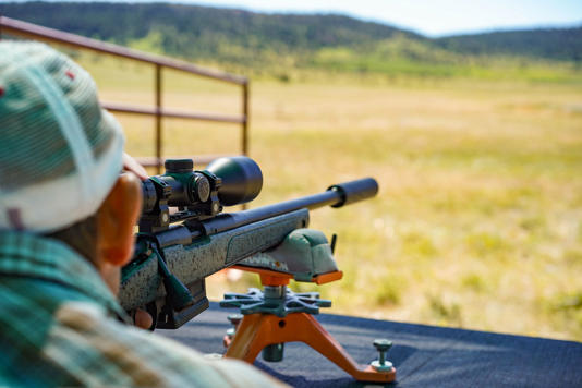

The author testing budget rifle scopes at the range. Scott Einsmann
