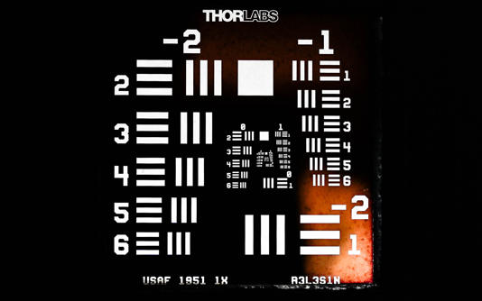

We measured the optical resolution of the best spotting scopes using a resolution target developed by the Air Force. Scott Einsmann

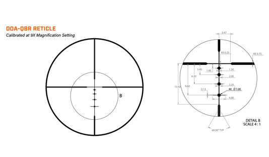

The DOA reticle is decent, offering MOA-based holds out to 800 yards and windage holds in both 5 and 10 mph right-angle winds. But the references are very fine, and some testers noted that they disappear against cluttered backgrounds.

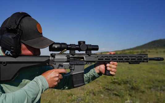

Testing the Vortex Venom LPVO with a mix of fast and precise shooting.
While the Viper was one of the best AR-specific LPVOs in our test, it would be a mistake to limit your consideration to AR-15s. The scope is a wonderful rimfire optic, and we found it to be fast and reliable for dangerous-game hunting. While we might not put it on a hard-bucking turkey shotgun, it’s suitable for straight-wall cartridge rifles.
The Vortex Venom’s reticle.
The heart of the scope is an MOA-based segmented circle. The 16-MOA circle halfway surrounds a floating 1-MOA illuminated dot. Non-illuminated hashes provide holdovers at 200, 400, 500, and 600 yards with a 100-yard zero and windage dots represent holds for standard-value right-angle winds. Note that the subtensions work only at the scope’s highest power.
The scope’s controls received mixed reviews, as you might expect in a price-point optic. Most testers recorded indistinct turret clicks and noted the illumination is useful only at the highest and lowest intensities. We also noted significant distortion at 1X, with convex “fishbowling” curving the image when we panned across the landscape. Do it quickly, and you can feel almost seasick.
But the Vortex has so much value, and brings attributes to the game that many of its peers couldn’t bring at twice the price, that it is the consensus pick for our Great Buy award as the screaming deal of this year’s LPVOs.

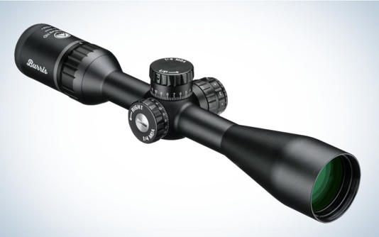

Just about any scope in this category can capably serve a Midwest whitetail hunter, but the Burris Signature, which has been on the market since 2020, has a few attributes that allow users to reach out across the distances sometimes required for elk, mule deer, and pronghorns. The scope’s excellent reticle and exposed locking turrets allow shooters to either hold or dial aiming solutions.
The Signature is available with four different reticles, both fine and bold plex designs, a BDC version with 6.5 Creedmoor holds, and the Ballistic E3 MOA, which is the version we tested. Tapered plex stadia bracket a fine center aiming cross, but what gives the E3 so much versatility are the three hash steps that allow shooters to hold out to 400 yards with a 100-yard zero. Cascading dots enable hold-offs for 10 mph right-angle winds out to distance, and 2 MOA hashes on the horizontal crosshair also inform wind holds. It’s a simple, useful, and fast reticle, but because it’s in the second focal plane, magnification will dictate subtensions.
The low-profile turrets pull to turn, and feature a handy rezeroable feature. Loosen a locking screw on the turret cap and you can reset the zero in the field, if necessary. Also in the plus column, a light 17.6-ounce build and a handy length of just 11.7 inches, making the Signature a good companion to a lightweight mountain rifle.
On the minus column, the glass. The Burris scored in the middle of the field in both optical resolution and low-light performance, and the lack of manual parallax created some focus problems for testers. But the team felt the price, around $400, is fair for the wide utility of this nimble, smart scope.
