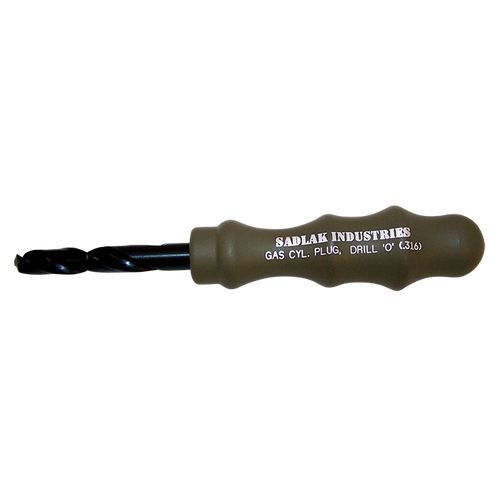

this is the gas block wrench
and the drills
