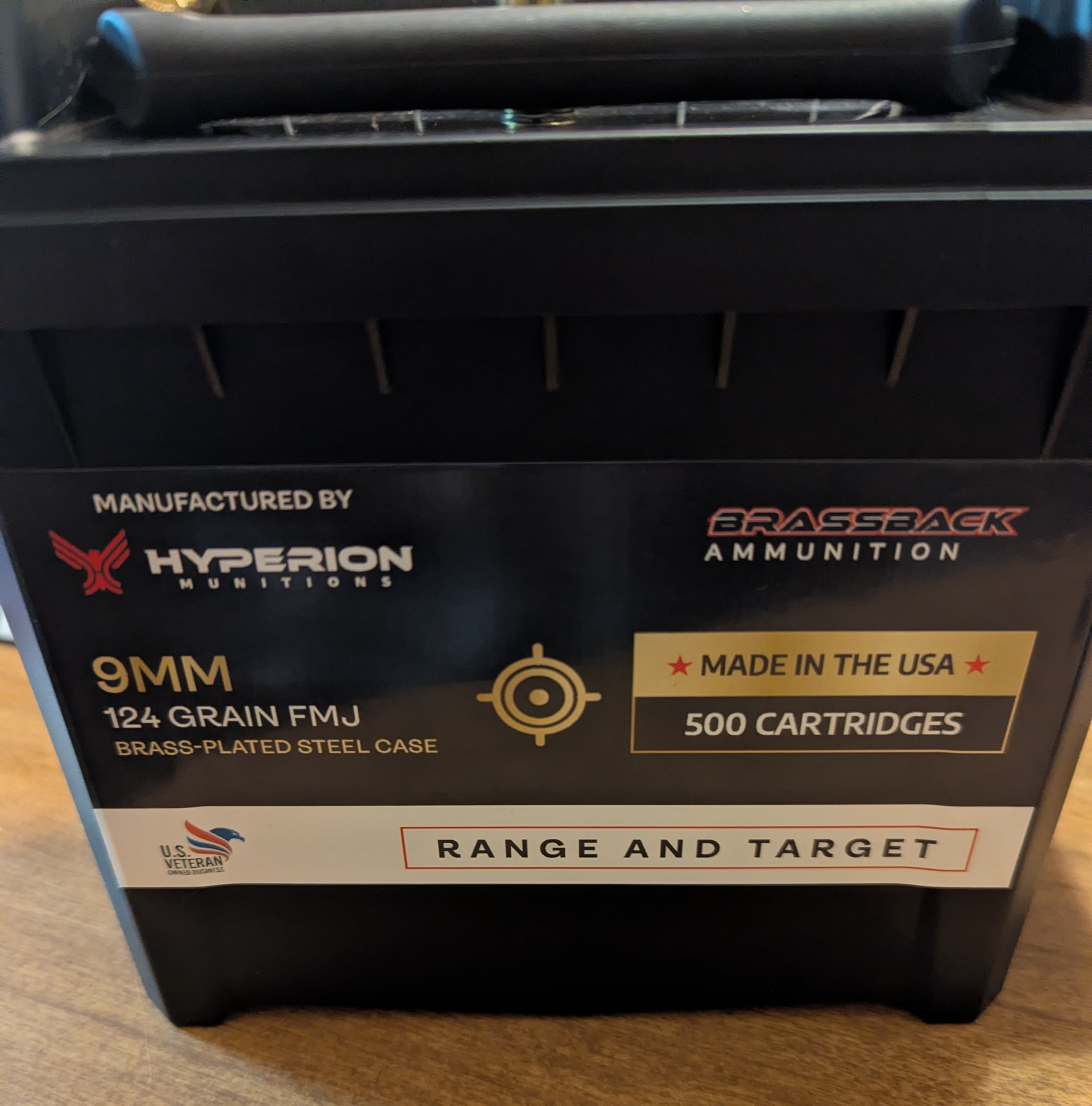

I found Hyperion Munitions and decided to try it out. 9mm 124 grain brass plated steel case rounds. They were super cheap for a 500 round ammo box. I figured why not.

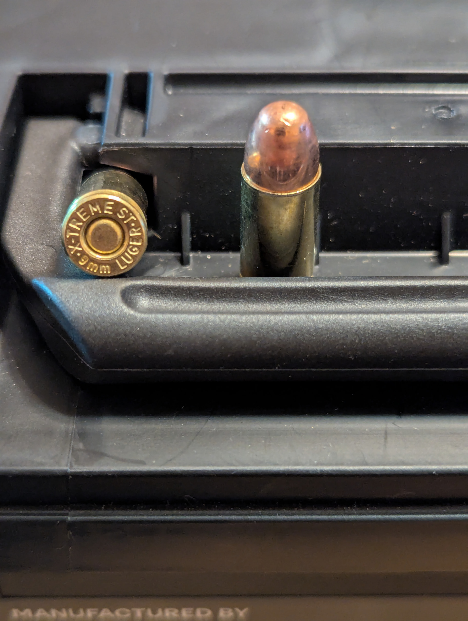

Well? When this malfunctions on three different pistols, then I can unsafely say don’t buy this stuff. Failure to feed I can live with. What I won’t deal with is when the casing expands so much after the bullet is fired that it can’t be extracted from the barrel. In 400 rounds that happened over 15 times (lost count but you get it). Thank goodness my Walther P99 has a simple takedown that doesn’t require a slide lock back. But… The others that do require it like the Sig or Glock?? Harder for sure. I had to rack the slide using the iron sights against the edge of a table to force it back. One had an optic, but it held up. Then I had to use a pick to remove the expended casing from the barrel after field stripping. In the end, I had other ammo, used it and they all ran fine after that. I was worried about extractor damage but no issues.
Gotta be honest: 1st time it happened I thought I had a live round in the barrel and it was a primer strike that failed to ignite. That’s because it didn’t happen to me the 1st time, but my cousin. I wasn’t watching him that closely as he’s an excellent shooter. But he’s not a malfunction fixer so … I was extra careful.
Moral of the story? Not recommended so run away. Here are pictures of the box and the rounds for you.

There’s your problem. Right on the box it says “brass-plated steel case”.
My SKS rounds, Wolf mostly, are steel cases but not plated and I’ve never had one stick.
I would have been dubious about plated steel rounds right away. (shrug)
