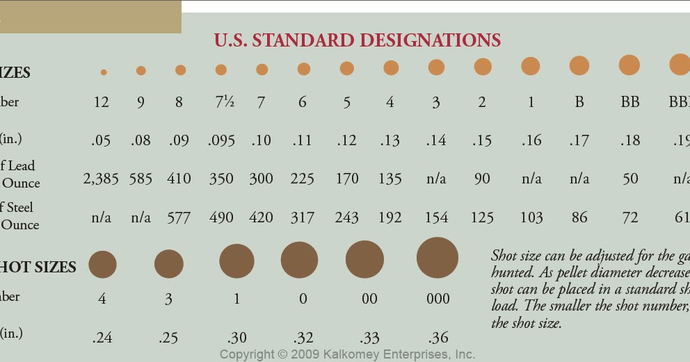

Following is a site that explains sizes…
I believe science says #1 buck is the best for self defense but 00 buck is so much more common that it is the standard.

The larger the pellets, the less that will fit in a given cartridge. 00 buckshot stacks single file one on top of the other in 410 gauge 3” length. In 12 gauge 3” length 00 buckshot stacks in clusters of three for a total of 15 pellets. Each one of those pellets could be compared to a 32 acp

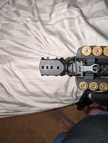

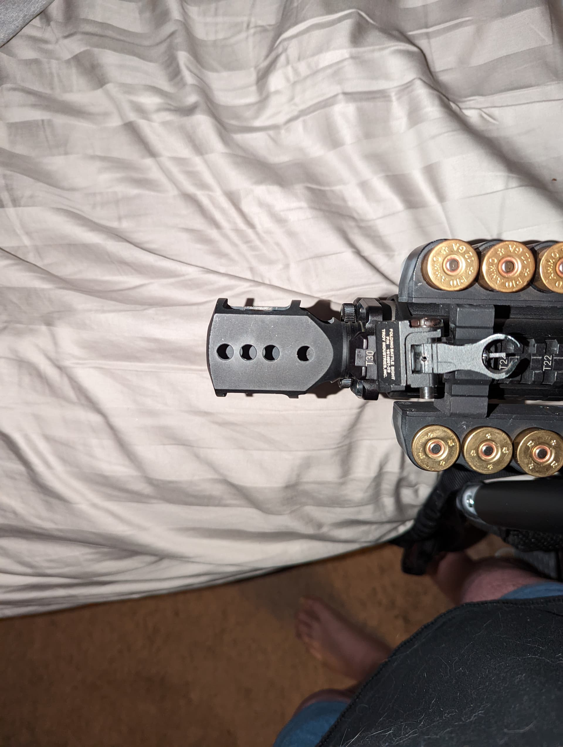

There is an after market muzzle brake you can put on your Kel-tec 12 guage (looks like a howitzer muzzle).

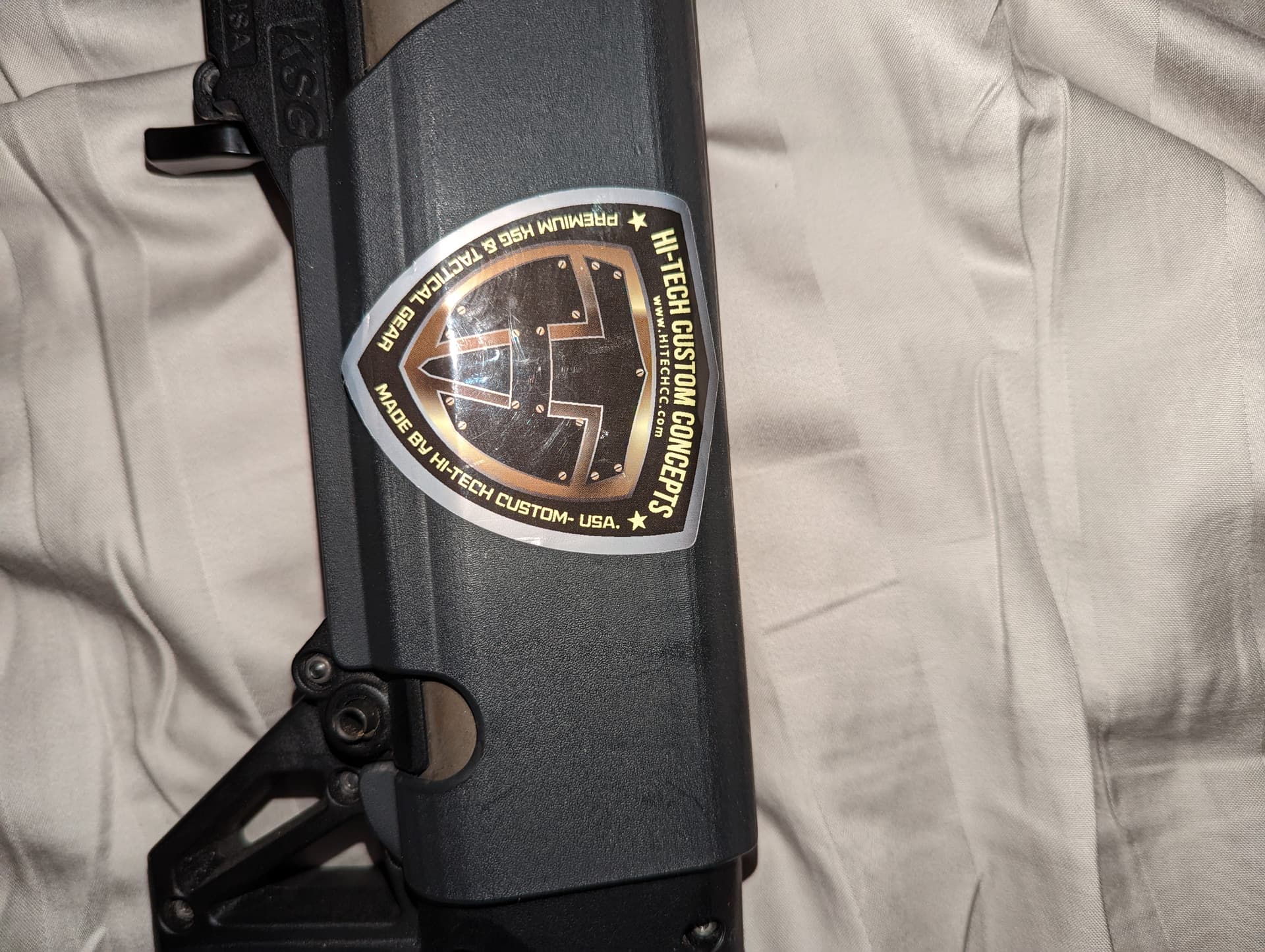

The sticker on the butt stock is who makes that muzzle brake. They have great customer service as well. It will also cure any recoil issues.
It’s sort of like firing a blow dryer. You fire and then you get this big wash of warm air as the muzzle vents back at you. I use any round size from 2.75 to 3.5 and I have 1 receiver with slug and the other with 00 buck. Plus it’s a bullpup. I’ve fired the mini loads you have described, the 1" slugs and the recoil was negligible.
Last thing. You have to be very precise when you are putting the new muzzle brake on.
