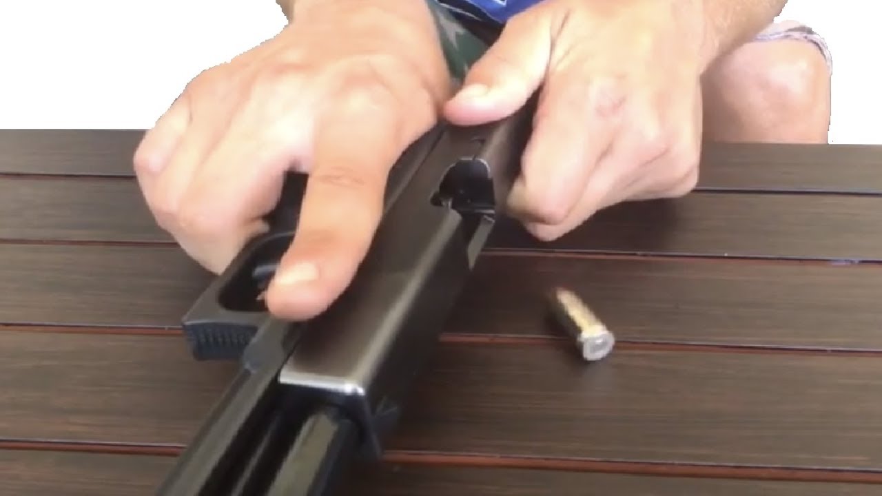

I try to continuously learn about safety from different sources with goal of combining best practices. I imagine we each differ in our strengths, weaknesses, and habits. I think it should be a never ending journey of education and training.
This subject posted is one of my faves because for many of us, we handle our firearm daily, and sometimes more often.
I think it helps to admit and acknowledge all the steps involved when handling, down to the smallest detail.
We hear of accidents in the “news”, but only partial. Know anyone who’s ever had an accident? I once heard a story. So, it was more impactful.
Revolvers might not be to everyone’s liking, but notice how when you check if a bullet is in the chamber, it’s more esily visible compared to a semi-auto.
However, with semi-automatics, when needing to ensure it’s empty, a “press check” may not be the proper way to check. Sometimes a “press check” can help you see that it’s loaded. But can you trust a press check to prove to you that it’s “not loaded”? No.
There’s a lot riding ‘on the line’.
Ask yourself what really is a press check, and how do you do it? Are you doing it best or correctly?
What is your goal? Going out, or trying to clear to inspect, clean, maintenance or “showing” the firearm to your family member or range partner who has never seen it before.
I’m sure there are some great tips out there, please share with the group.
Some ideas:
- Pointed in safe direction
- With the safety “on”
- Remove the magazine
- Rack the slide to empty out that live round which is or could be sitting in that chamber (it may fly out the side and softly land on your table or floor, or it could fall through the open mag channel)
- Press check
- Open the action
- Lock open the action/slide if you can
- Look down into the mag
- From the rear, look at the chamber (critical)
- From the rear, look into barrel (critical)
- Remember, it’s dark in there and if you pull that slide back, do it slow so you see
- That bullet could be hidden, inside that barrel, with its casing hugging the chamber – ready to fire
- You might not see the whole bullet, the only thing visible might be the back of the casing - which means it could be loaded/still live, unless it was a fired bullet that failed to eject (rare)
- Is there a live round sitting in that chamber/barrel or not?
- If the bullet or casing is still inside that camber/barrel, it could be stuck and you would need to remove it manually by hand or with an instrument
- Be very careful not to allow the slide to bite or chop off your trigger finger you if it were to slide forward or if the slide stop lever moves
- Always have a mini flashlight on you, in your pocket, and shine it into the “rear” of the barrel chamber to look for a live shell which could be embedded
- Never insert a snap cap unless 100% assured that it’s been cleared first
- All while never pointing it at anyone, nor at yourself at any time during inspecting
Why is this important?
The end of the shell casing can be dull in color, not stand out, normally they’re not neon bright.
Depending on the caliber, the back of the shell could be thinner than a dime, smaller than any button on your TV’s remote control
Ramifications of an error? How would it make you feel? Tips/suggestions?
Video attached
Good remainder @Burdo . Safety is the most important thing that has to engraved into our brains.
So even you posted it already I will write it down again, because more we read it, more we remember it.
- point the muzzle in the safe direction
- remove the source of ammunition
- rack the slide at least twice and then lock it open
- visually inspect chamber and magwell (from the top)
- look away, then look back and visually inspect chamber and magwell again
- put your finger into the ejection port and physically inspect chamber
- put your finger into bottom of magwell and physically inspect it.
- If you shoot with other person, let him/her inspect your chamber and magwell
This is the procedure I’ve been using whenever I’m practicing alone or teaching others.
I never start teaching without verifying all others understand this procedure.
One pro tip I’ve learned. Sometimes handgun manipulation with keeping the muzzle downrange is hard. Simply standing sideways to the safe direction (downrange) and front to your handgun fixes the problem.
Press check is good… if you know what you are doing.
It is not to verify empty chamber and safe condition of the firearm. It is to verify the round is in the chamber. These two are not the same.

@Burdo ,
You forgot to indicate the video is an example of how to not handle a pistol, unless your intent is to shoot yourself in the hand
