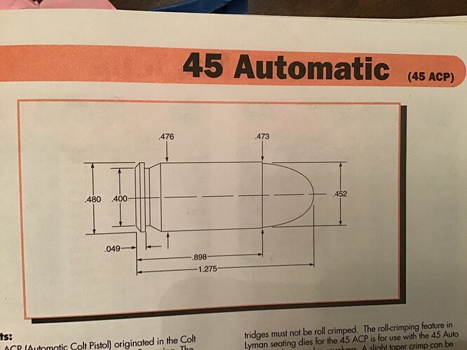

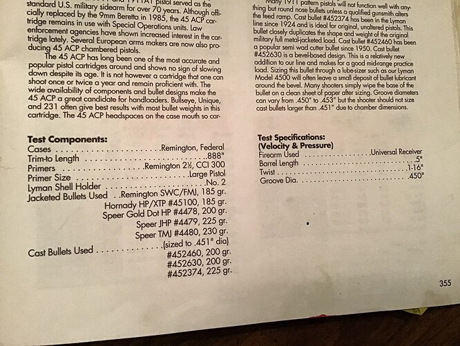

Regarding this chambering problem some of the common causes can be

I have the same issue with my 1911
.452 don’t go
.451 go
haven’t checked the S&W shield yet
so far that thing eats everything
