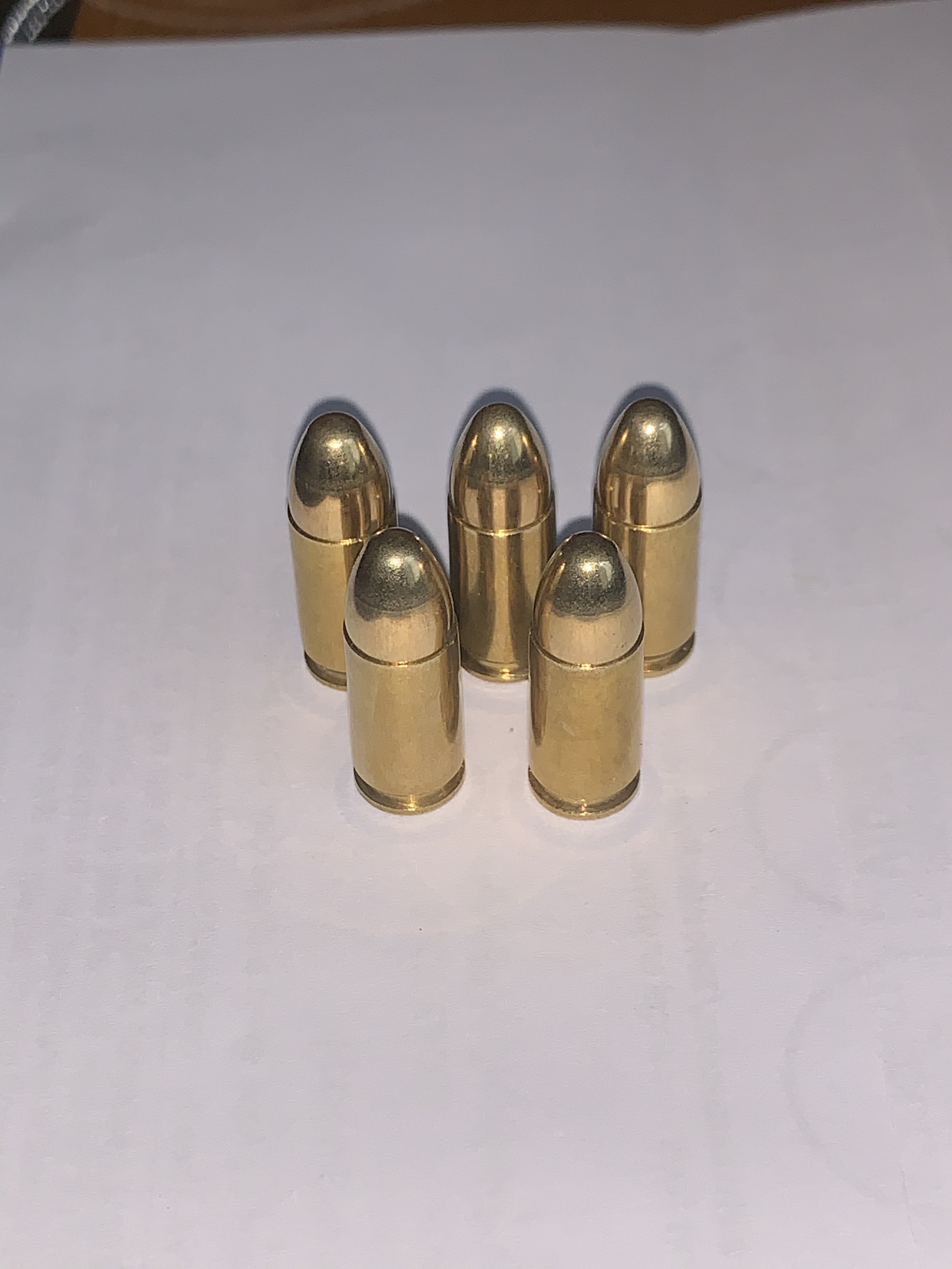

Been familiarizing myself with it by cleaning and adjusting. I got through flaring, seating, and crimping. Made 5 demo rounds without primers or powder. They all passed the case gauge test and they cycled through 3 different firearms without a hitch. The OAL spread was most between 1.131 to 1.135 with one that was 1.141. I’m thinking that’s ok since I was using mixed cases.

Are those your first 5 rounds you’ve made?

Well, I ran a few through the paces. Flared a couple, adjusted, flared a few more, then seated a few, checked OAL, adjusted, seated a few more, etc.
These are the first 5 rounds that I ran through the full cycle except for primer and powder.
Awesome, and not as crazy hard or as intimidating once you get into it, is it?
Beautiful work… those look like Fiocchi rounds. What kind of bullet did you use?
I used RMR FMJ RN bullets. I’ve been stalking reloading sites and they came up a lot. Nice guys and they happened to have some in stock when I was looking.
