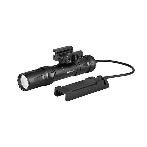

However, having had Olight’s magnetic charging system for a while and running their EDC lights a lot I have grown a lot of faith in them.
First, older rechargables used to drain (a lot) over time. There was a very real risk you’d pick up that light and it has only half a battery left when you need it most. Newer lithium-ion (and specifically Olight branded) only loose like 5% per year max (I dont have the source handy as I write this, if I find it I will edit this post). So you could leave it fully charged in your rifle in a safe all year round, not worry about it and maybe top it off once a year, just like I replace old batteries once a year. The cost savings in just one year is notable (if you have a lot of lights
The second thing is something I read online which gave me pause… I have a small stash of batteries, but it requires me to go buy more every few years. Right now, the batteries are common enough (mostly 123A or 2032 watch batteries) that you can find online easily and even in a lot of big box stores, sometimes even a convenience store. In a true SHTF scenario, if you use lights a lot you will quickly burn through your stash and not be able to replenish them (because the S done HTF). So if you have a rechargeable light you can recharge via the power grid (if its still up), OR any of the numerous power banks (the kind that charge your cell-phone), USB power off of laptops, AND (the best for last) solar recharging.
Since you only need to charge it once a year or after you use it (for a class/range trip) it almost doesn’t matter where you put the charger. I would not take the light off the rifle, you can leave it on and the mag will connect right to it (you may have to remove the switch if you are using one). If you put it in the safe, you can probably jury rig a portable power bank to attach within reach of the rifle.
The best case is you have a light that accepts both rechargable and disposable batteries, but outside of Surefire DuelFuel and Streamlight’s HL-X I don’t know that is very common. Rechargeables like 18650 and 21700 also have so much more power available to increase brightness, runtime, and often both.
